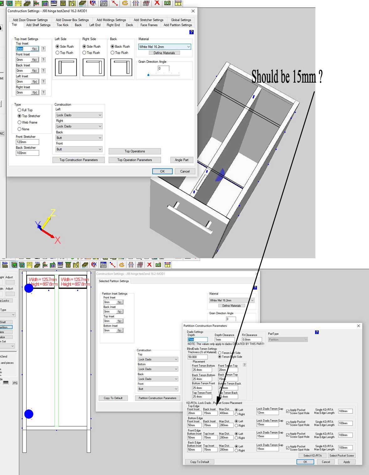

But anyway while I was messing around all I was able to get was this to happen, in the attached image with these settings the KD pattern appeared, it would appear that the back inset in the back rail isn't getting applied,it roughly looks about 40mm instead of 15mm.
When I changed it to a back rail of 120mm the KD pattern disappeared.

I tried your settings and played around with various mixtures and was unable to get a dado at the back either.
I'm not really clear on how the dados get applied to the partition and the rails at the top. Are they applied across the whole top or only to the front one, or only where the rail touches the partition.
