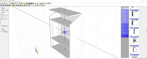

We need to build angled top cabinets. See pic.
Can I do this in eCabs with the top or do I need to use stretcher to make the top angle front to back? Follow side does not work under Angle Part

A stretcher woul work best if you need to resize it in the future. How ever a display panel is a lot easier but will not resize with the cabinet.

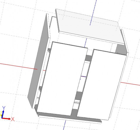

Just closing the loop. Made with stretcher. Calculated length using geometry of triangle, added for mitering the edges to vertical. Doors size correctly, etc.

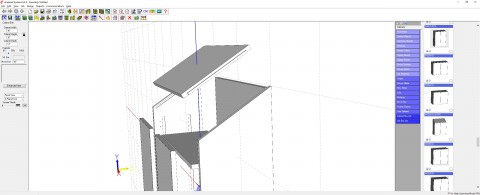

Did you ever come up with an easier way to create the slopped cabinet? Display panel you can rotate but won't resize with different width's. Stretcher you can't rotate to match slope. Plus I wanted to use Lft. & Rght. blind dados.

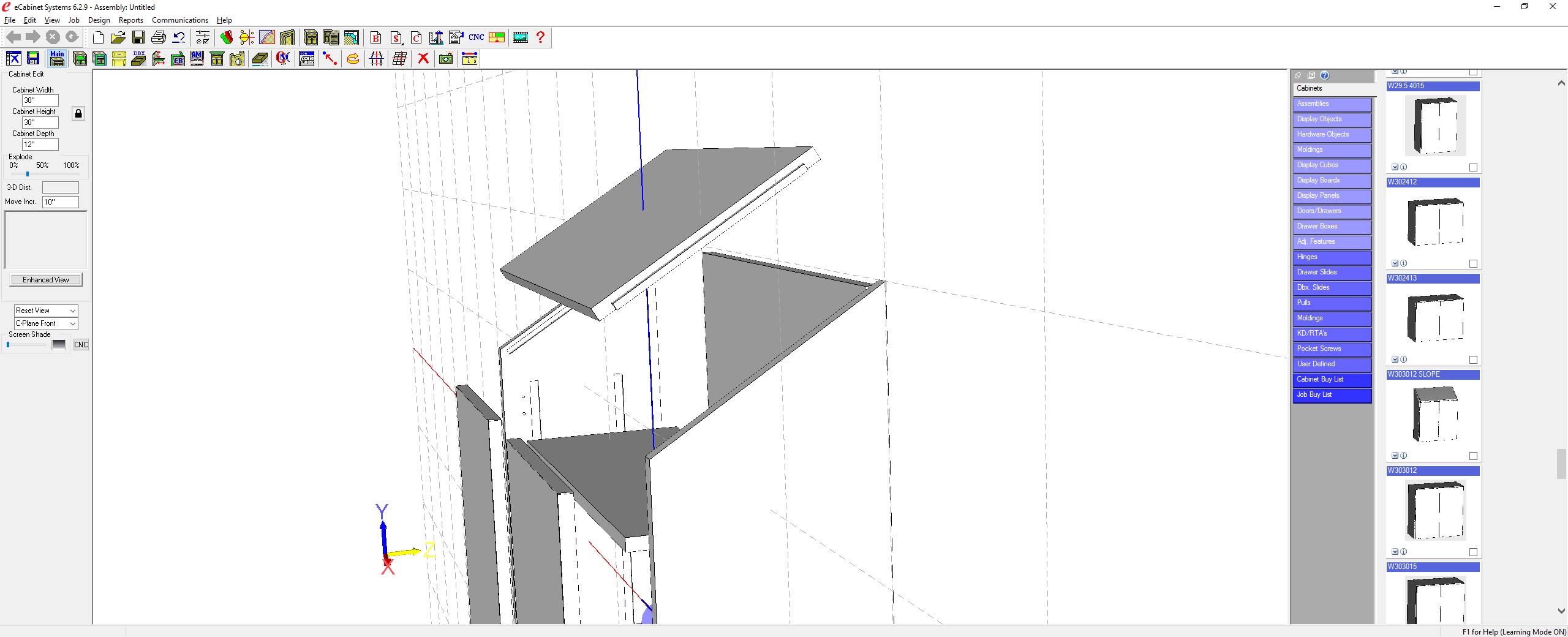

Chris, first picture is actually hard to see but the stretcher is in fact sloped. In our case, we rotate 148 degrees and adjust insets and it worked like a champ! Maybe this is a better picture.
