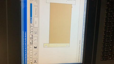

Just encountered a weird issue on my CS41 . Everything has been fine for years, now:
Each part is being nested on its own separate sheet (and the sheet looks to be the same size as the part itself)
Some parts are also extending beyond the bed when nested.
Any ideas ?

OK panic over,
for some reason I had the 'Scrap Part Recovery' checkbox ticked in the load screen . Phew.
