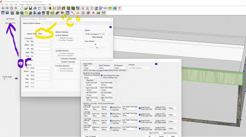

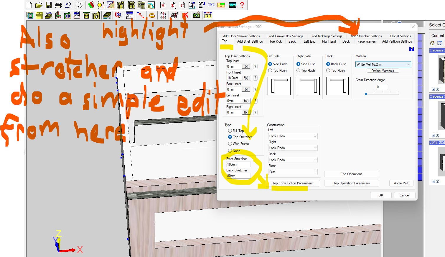

Hi Tommy.
I read your question in 2 ways.
One way is to do them in the stretcher editor, you can adjust individual stretchers by highlighting and clicking on C or using the adjust stretcher dialogue which has two or more layers of additional controls.
Or are you referring to a top shelf stretcher.
I can't think of a way for global or directory wide modifications, but others may have a way to do it
