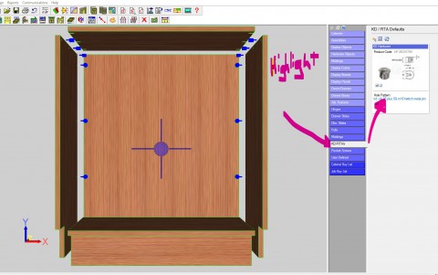

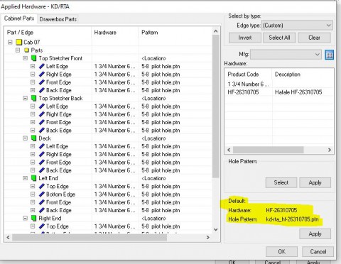

I have a question. Is it possible to change in eCabinets the Default Hardware and Hole Pattern in KD/RTA construction?
Please see attached Picture, highlighted
Thank you
KD/RTA Change Default

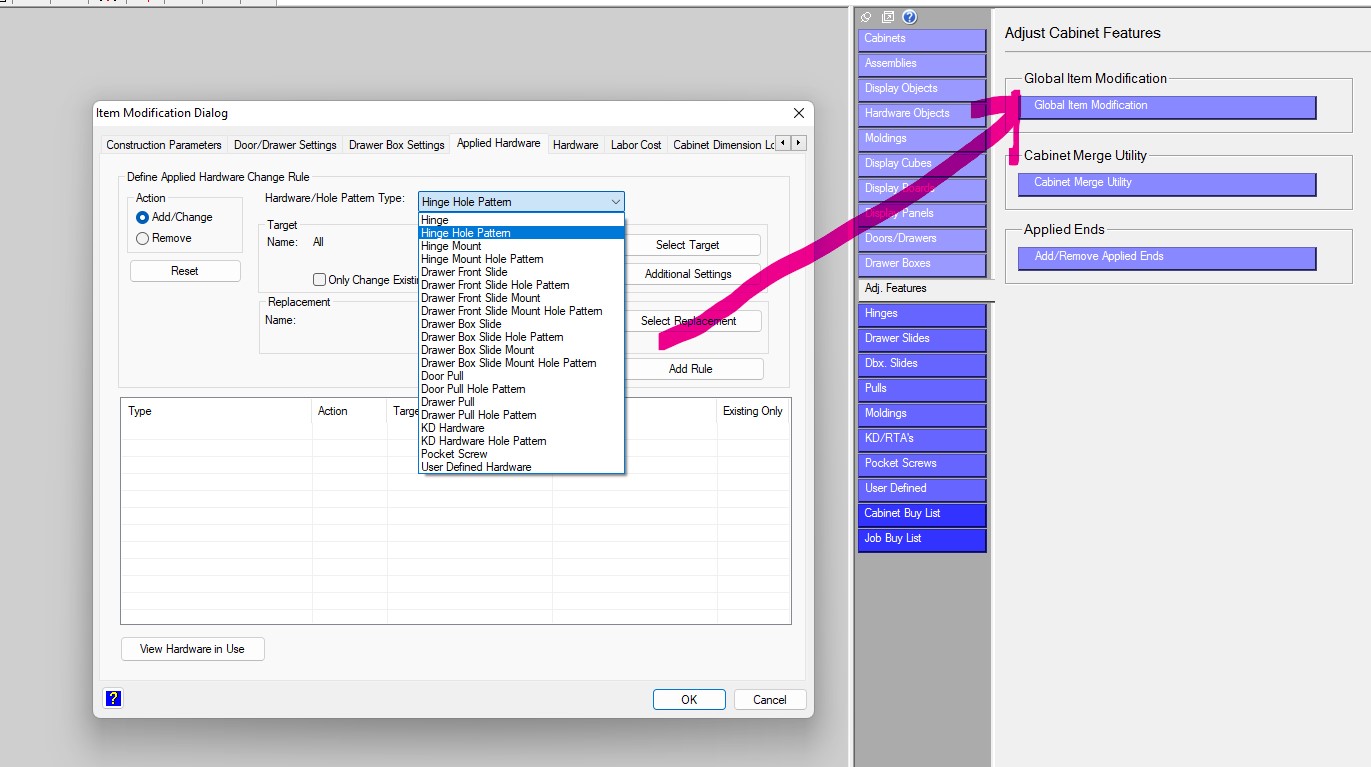

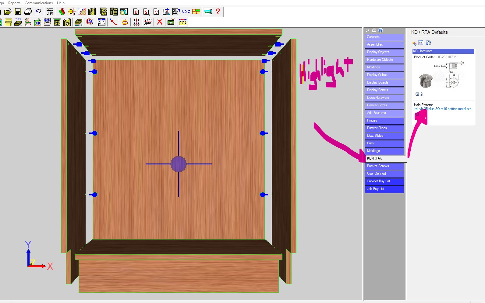

I haven"t been able to do it from there.
I use the main window and the KDA Rtas as in the attached picture to change the default.
It sticks even when you save it.
You can change all the fittings or patterns for a directory in global modifications.
Always make a backup so if something goes wrong, nothing is lost.
