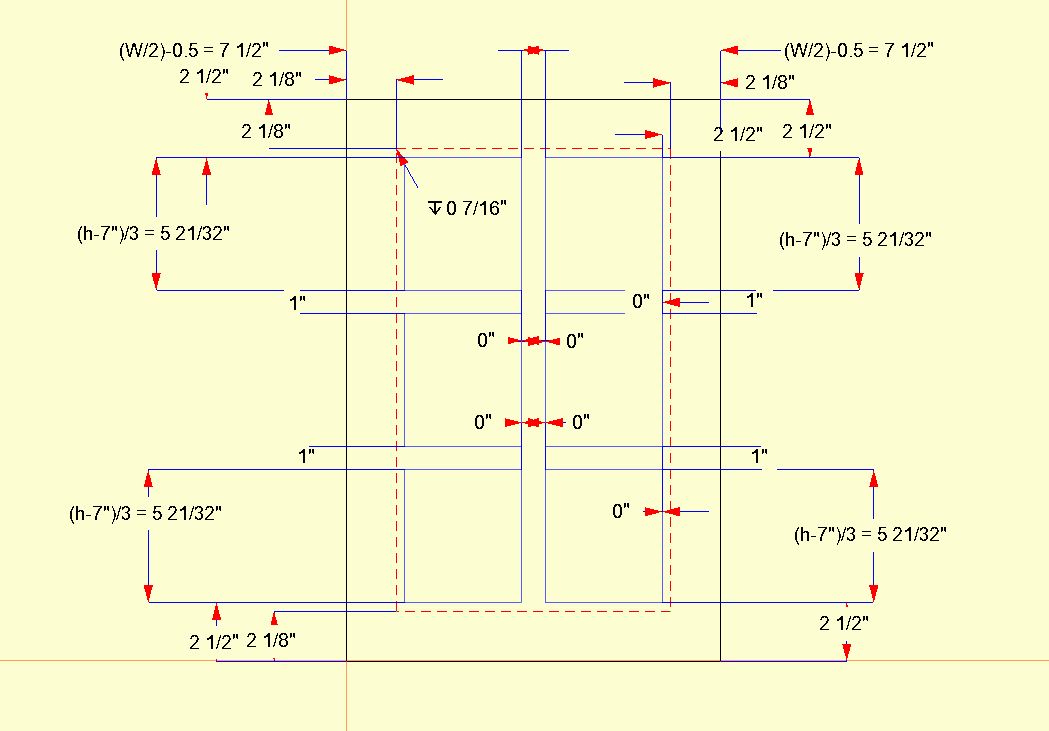

I have to agree with Kerry. I have a large library of commercial cabinetry with all sorts of part editor cuts for different applications. The only way that I have ever found to have cabinets be resizable and still maintain the cuts is to use the constraint manager. I also agree it can be confusing and frustrating since many times it feels like you have to constrain absolutely everything to the point of being redundant.
As a side note does anyone else wish we could reference the dimensions of other parts of a cabinet in the constraint manager? Say for instance you put a cut in the side of a cabinet and wanted to constrain it based on the thickness or width of the top or deck of the cabinet. Maybe there is a way to do this I don't know about but its just a thought.
