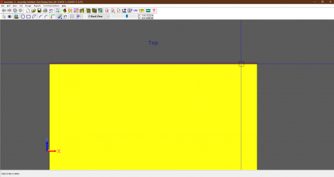

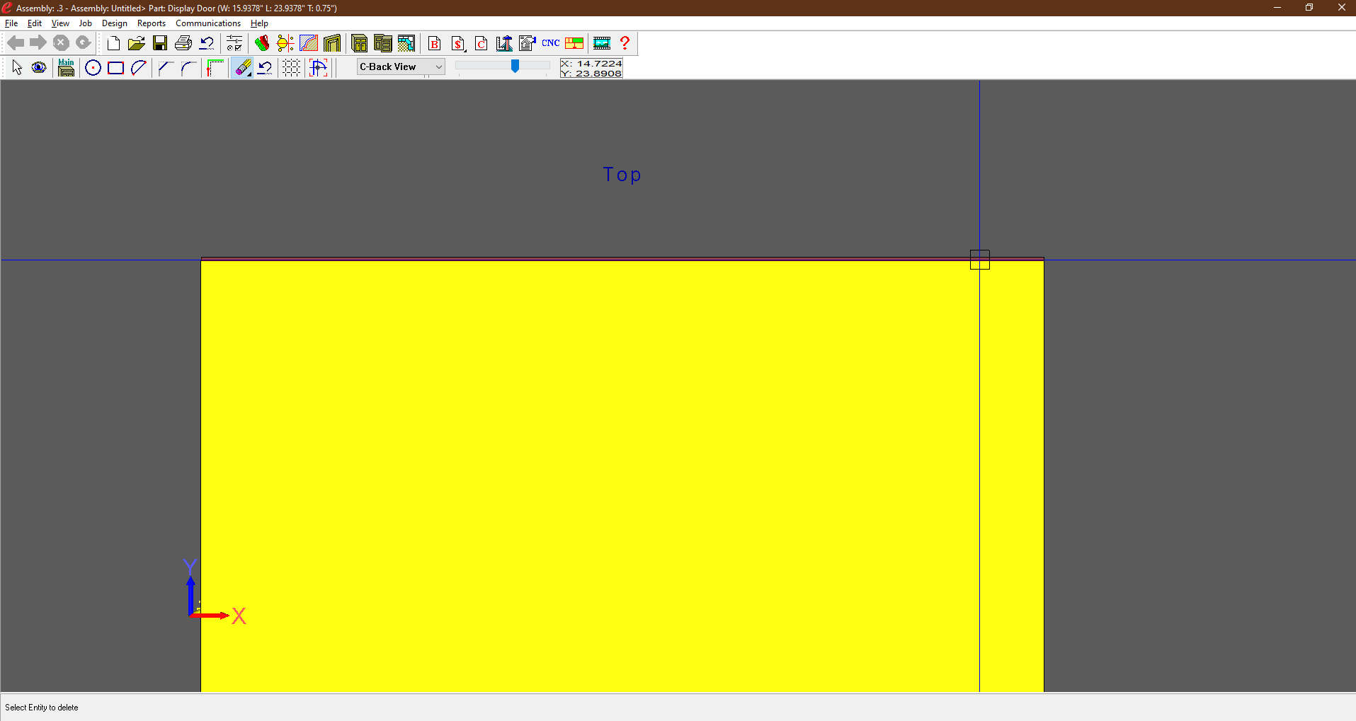

hey I've been struggling with these part edited doors and drawers that have certain patterns which need to be constrained and it seems i part edit from the design tab then door/drawer editor, then go to constraint manager there is a slit cut off of my door, which i then have to go to part editor to delete it
this is very frustrating because it seems like that also causes minor bugs like constraint manager constraints lose a reference point and sometimes deletes the part edit cuts entirely, this is also happening when i part edit a door from the cabinet editor but i'll be showing pictures from the design tab- door/drawer editor down below
i attached a step by step picture of when the problem occurs see attachments

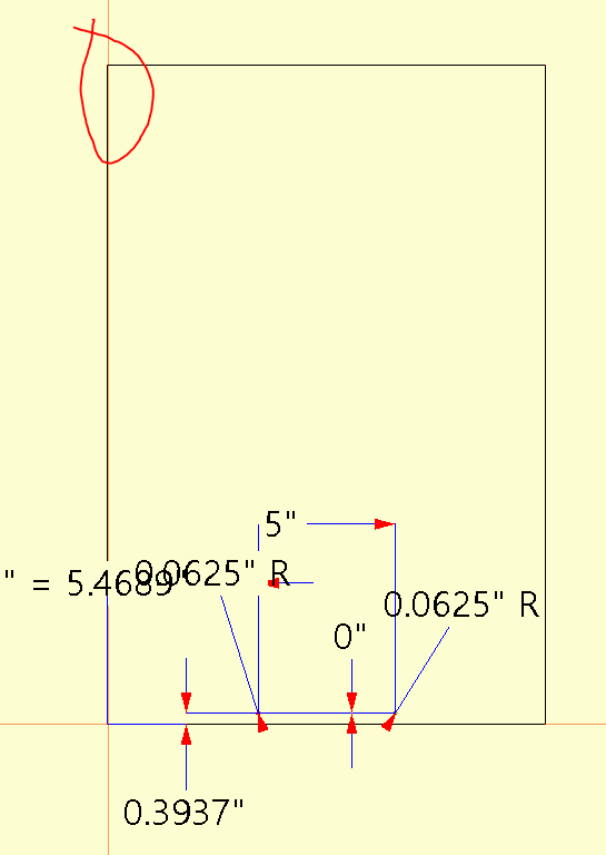

once i delete the part edit (refer to step3.png) then i continue constraining and thats when interesting.png happens, where it seems offset by a mm
also the circled part is me wondering if maybe door edging is causing this problem? it looks like it overlaps from the y axis grid line seems like its shifted to the left of it by something like a millimeter

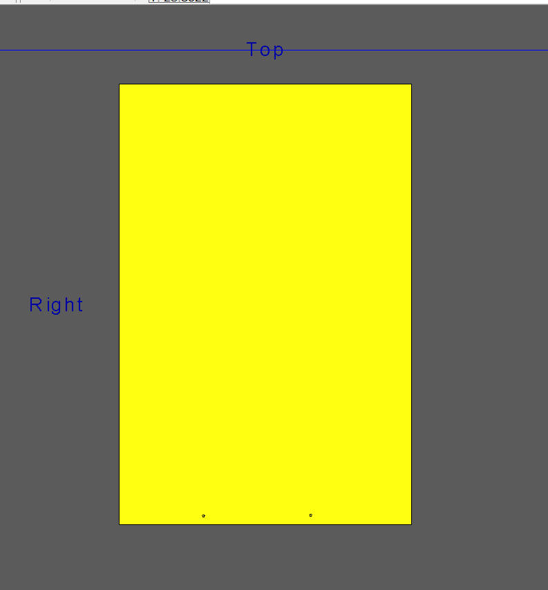

the pictures are from the first part editor picture bottom to top they indicate exactly what i do to make the handle holes that i placed which you can see in the constraint manager
the steps were, part edit and cut out using geometric shapes (1/8 diam circles)
constrain holes to proper size and location
go back to main which in this case is door/drawer editor (while part editing doors with edges i always have this problem)
then when i go back to part editor the slit randomly appears and constraints are lost
you can recreate this problem by adding a slab door with edges from the design tab at the top and making these 2 holes and constraining the holes properly

When I examined it in the part editor it seemed okay. When I zoom in I cant see that slit. (it does look like edging in your image)
The door came into my ecabs unconstrained.
Unless somebody else comes in with an answer, My two cents.
I used to have a lot of problems with constraints. I still do sometimes, but cleaning up how I constrained solved a lot of problems.

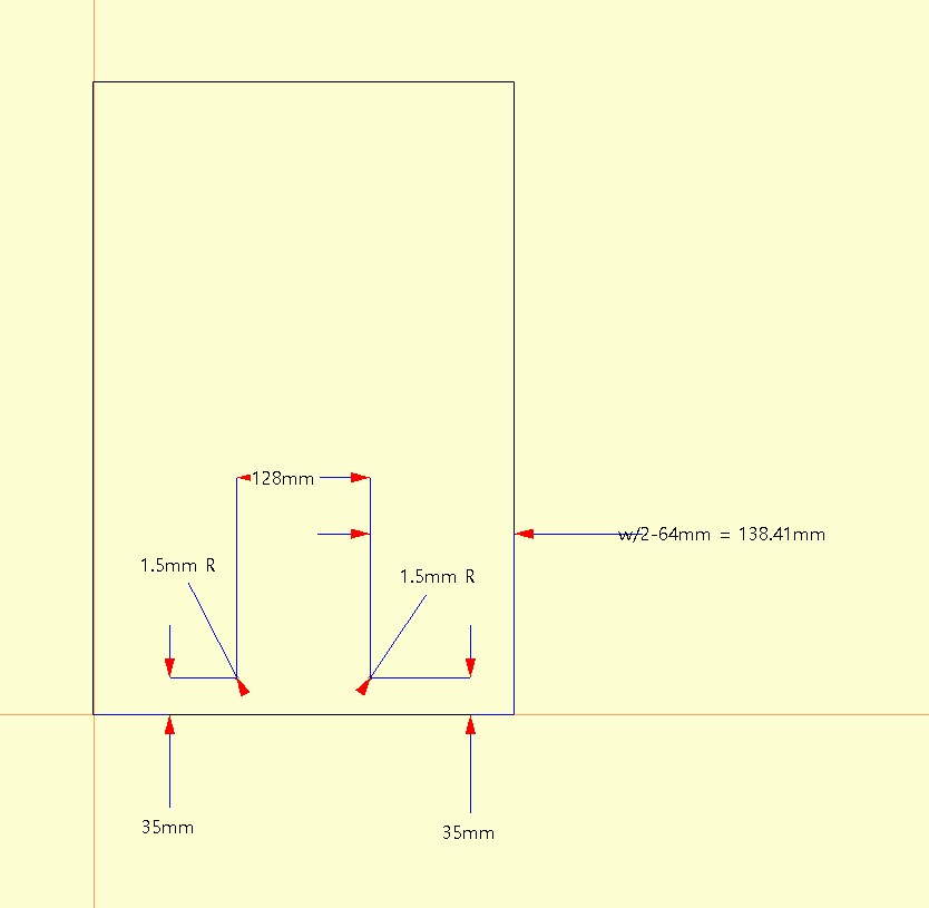

So see that zero constraint, I think that is where you tried to tie the two holes onto the same dimension, From my experience the back end tries to join or put those holes together and tends to then drop the constraint or something. I was once told by Scott Val (a previous mod like Clint) That ecabs doesent actually like two points in exactly the same spot, I think it needs to track where every point is and when two points are in the exact same spot on the same layer it gets a headache differentiating the points so tries to fit them together.
If I was constraining that configuration I would constrain each hole separately.
I have attached your door constrained how I would do it.
I have also found formulas can save a lot of time like, the W/2-(half of handle or half distance apart width) will resize with the door.
I notice that the holes don't go all the way through, If they are supposed to go all the way through I would do that in the part editor, also when you add them in the part editor just type in the diameter. Then the diameter and depth stick to the hole without the need to constrain.

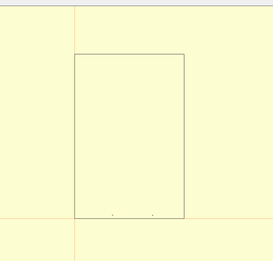

Post by Nicholas Kiss »
[quote="Mark McCallum"]
thanks Mark, i like the way you formulate your constraints; the holes are supposed to not go through all the way
i tried to recreate the door again and this time the problem is in a much higher caliber, I'll link the doors again and if it looks right in part editor then try hitting the eraser and it'll show just how messed up it is, hopefully someone can look at this

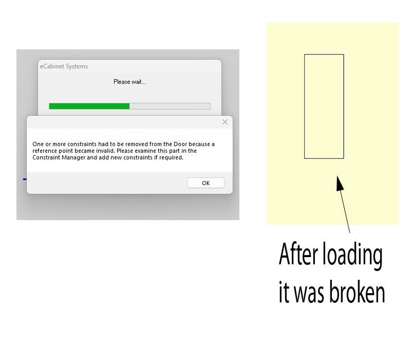

I couldn't load your door as it was broken and I have attached the error messages.

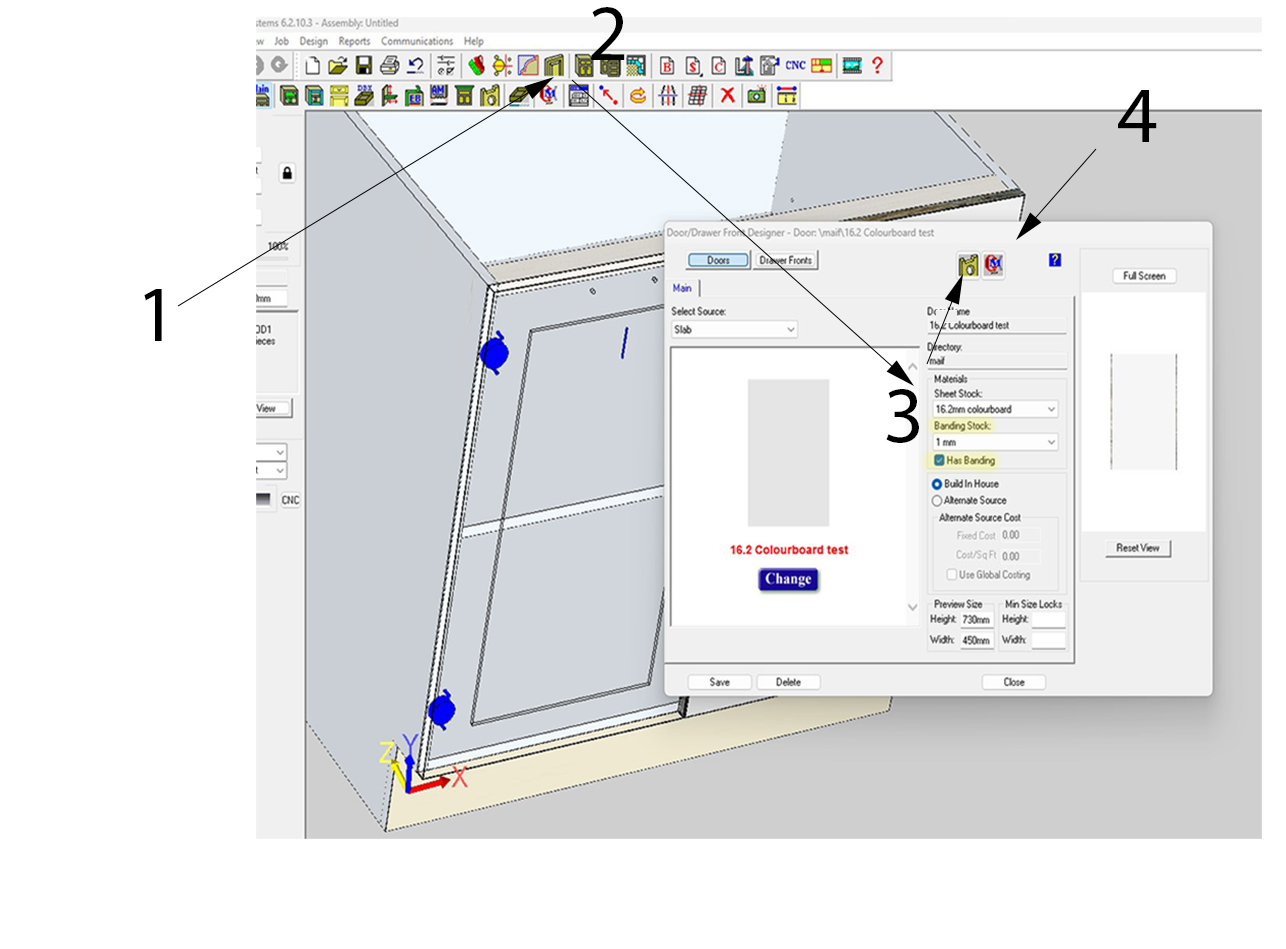

Also, I still wasn't clear where you are part editing from so I attached an image of how I think you are
doing it.
