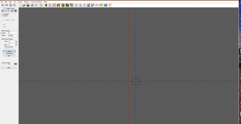

and it didnt let me add the .ptn file for you guys to look at but u can recreate my predrills by making a 1/8 dia hole like this with the depth set as you see
