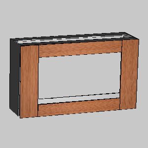

Hello,
I'm trying to build a wall cabinet that the top and the deck are of different depths and apply a face frame to it.
The top is 23" deep and the bottom (deck) is 18" deep.
I've managed to produce the cabinet and when I apply the face frame to it the face frame doesn't tilt and sick to the front, instead it just hangs there perfectly vertical.
Perhaps there's another way to accomplish that.
The cabinet is to hold a chalkboard with a menu.
Thank you for help.
menu board.hsf
(344.02 KiB) Downloaded 392 times
menu board.jpg (11.19 KiB) Viewed 3469 times

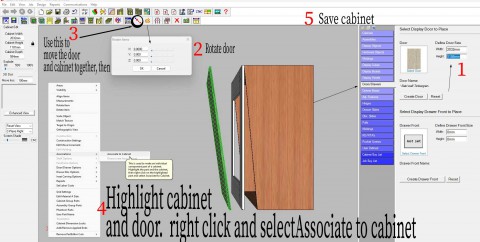

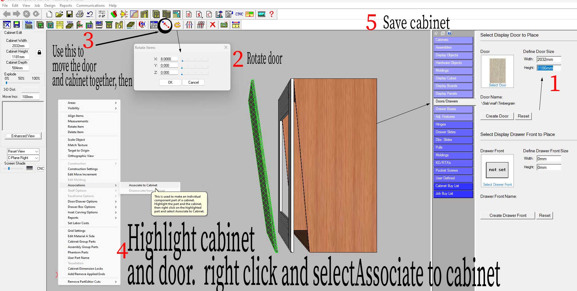

Re: Placing a Face Frame on a wall cabinet with a slanted front
Hi Gheral
I would perhaps try add the face frame as a door,
Add a door through the side menu as in the attached picture
Hopes that helps
Mark
