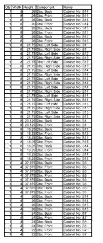

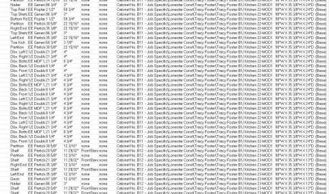

Re: Cutlist programs
Forrest,
If you are needing a cut list for your sawyer, I would pull the drawer box parts from the eCabinets sheet component listing in excel, clean it up and sort it. You could record a macro to automize it a bit and go from this:
to this:

Thanks Guys,
So I'm currently doing as Kerry describes and then loading that file into an online optimizer that I went ahead and paid for. I can sort and save the xls file as a csv and import it to the cutlist and it will nest each width material into cut sheets. I print those out for the panel saw. I still nest the bottoms on the machine.
This works fairly well but I was curious if it could be done in excel or access.
Jeremy's method requires placing each drawer in said material unique to its height and as far as I can tell doesn't allow for swapping them in globally so that's why I haven't really considered it.
