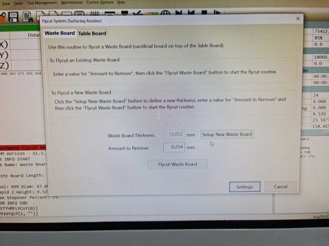

How do you change the waste board thickness without flycutting?
- Posts: 539
- Location: Sydney Aust
Is there a way to change the thickness of the waste board with out doing a fly cut?
I seem to want to do this fairly regular and I wonder if you guys have a simpler / easier way.
For example.
We cut benchtop blanks for laminating and one material thickness is 33mm x 3600 x 610 and the other thickness is 32 mm x 2420 x 1200.
I want them to be the same thickness.
So to thickness the thicker sheet, Mid job, I bump up the thickness of the waste board to existing waste board thickness plus 33mm, change the width to 640 and flycut it down to 32. All good.
Now I want to return the waste board to the old thickness.
But I cant find a way to just return it to the old thickness.
To get the old thickness into the settings I have to set the waste board to the true thickness plus an amount to flycut, so plus about .2mm for simplicity.
I then have to run the flycut procedure to get it to accept the original thickness.
It seems to need to load the flycutter then proceed to the ramp down and start flycutting before it takes the size.
So to be safe I push the sheet out of the way to save any mishaps.
I have tried putting in 0mm but it doesn’t get saved.
Just wondering if I’m missing something or if there is a simpler way to do this.
I can understand we don’t want to forget to flycut a waste board but a button to accept without flycutting would be handy.
Thanking you

In the THM control, click on the file menu, edit dropdown, then go to machine variables. Scroll down until you see the value for wasteboard thickness. You can edit by double clicking on it. BE CAREFUL, a fat finger here can make a bad day. I often copy the existing value to the clipboard before changing it, so I have the old value without memorizing it, in case I get distracted or change my mind. This is a machine setting, not a nesting setting, so these changes can bite you if you run out of order.
I change this variable with the weather and humidity, to adjust for over/undercutting when the board swells/shrinks.

In Control Nesting, go to the CNC Settings dialog, and enable the "Ck Waste Board Every Sheet" checkbox. This will throw up a dialog before cutting every sheet, enabling you to enter a custom wasteboard thickness before cutting. just a thought...

I do it so often I can do it in my sleep:
CTRL-M, TAB, W, ENTER
Type in the new thickness. Easy peasy.
CTRL-M brings up Machine Variables, TAB puts focus into the variable window, W jumps to Wasteboard Thickness, ENTER highlights it, ready to type in the new number.

Thanks Guys.
Those are both very good options.
I like to stick within the fences when changing things on the machine.
Tommy, I hadn't thought of that one at all. I like safe-mode solutions
One day, I hope to become fully-pro like Jeremy and Tommy.
I only venture into machine variables rarely, and mainly to adjust for flip ops.
You must live on your machine Jeremy
I like the hot keys
Thanks for the tips

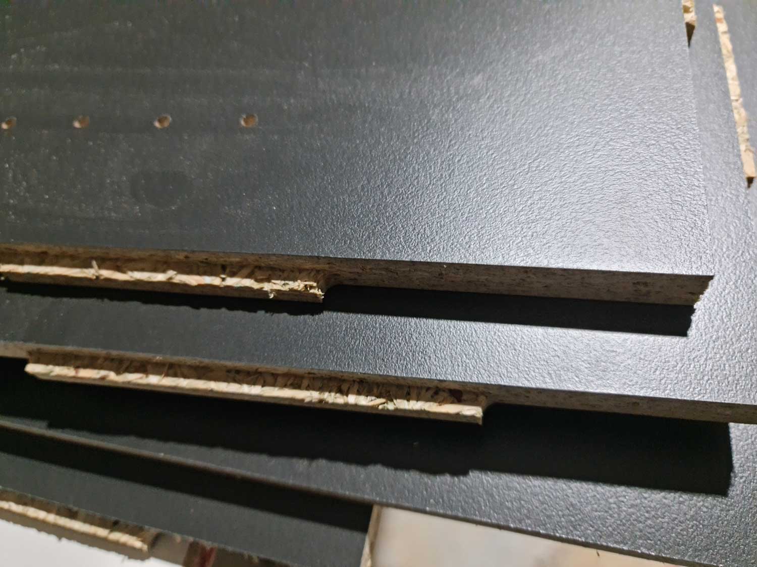

We use the lock dado joint quiet a lot and when they nest on flip ops it is quit easy to see how far out the alignment is.
There are gaps in the joint.
I have a couple of test pieces that we cut to work out which way to move it
I keep a vernier handy and measure the amount that it is out by.
So keeping in mind it cuts the flip op first you have to work out whether the machine thinks the locator pins are closer or further away and then adjust the 1st table longer or shorter or wider or narrower by the amount that it is out as read with your verniers.
I then cut another test piece and perhaps tweak it until I'm happy.
Its good to check for square 1st because that messes with flip ops as well.
I put a cover or waste sheet on and cut two 1180mm squares, mark x and y put a mark in one corner and flip one over so they are face to face line up the y side and see if there is any variation, it will always cut parallel but could be cutting rhomboids.
It will be out of square by half the distance of the variation.
Adjust and re-cut the squares down to 1170 test again.
Anyway hope that makes sense

I usually just use an edge finder such a this one https://www.amazon.com/Mitutoyo-050101- ... r=8-5&th=1. Mine specifically is a General Tools 260. Load it in a tool holder, locate a sheet of material into the pins, mark on the sheet where the pins touch, vacuum on to the table to keep sheet from moving, turn the spindle on at 1000 rpm, teach the machine over to get the edge finder touching the edge, it will get near perfectly lined up with itself, then kick out once you are right on. Raise up, step in the radius of the edge finder, Shift 8 on the handheld, make sure offset number is correct at the top, Shift 1 or 2 to uncheck the axis I don't want to record, enter, move on to the next pin. Using an edge finder lets you step in .001" at a time with a visual reference to get it dialed in. My other method without an edge finder is pinching a piece of paper between a standard tool and the edge of the sheet. Requires a bit more effort.Mark McCallum wrote: Thu, Aug 10 2023, 8:43AM Hi Tommy.
I'll have a go.
This is just my way and I might have it a bit wrong.
Jeremy and others probably have other ways, (maybe / hopefully simpler ways) of doing it, but it works for me. (yes and I use the snipping tool take little notes and photograph the screen as you suggested).
So in machine variables there is table1 and table 2
The way I understand it is that Table 2 is what the machine uses most of the time for every normal sheet.
Table 1 really means side one, or this is the1st side to cut the flip ops into.
Normally when we only cut one side it doesn't refer to table one because everything is retaliative within the board.
Anyway hope that makes sense![]()
