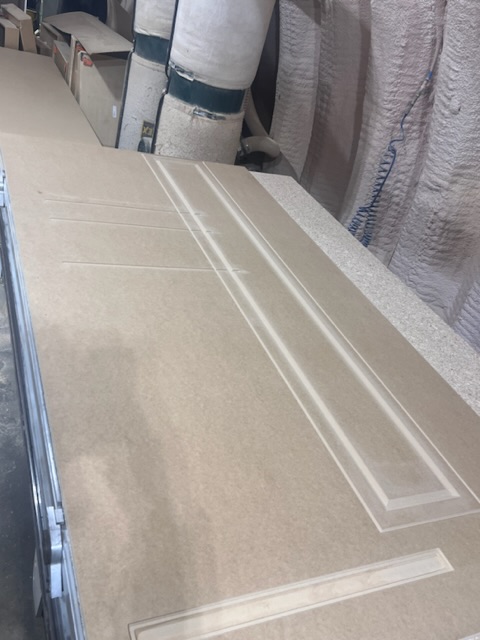

Working on a door that is Raised panel but has an issue after all is done and profiled correctly if you add a handle you get one issue that looks a little different but if u go to part editor on that completed raised panel door then it shrinks to the size of a drawer face of it's own accord
all information for the job will be added as a link

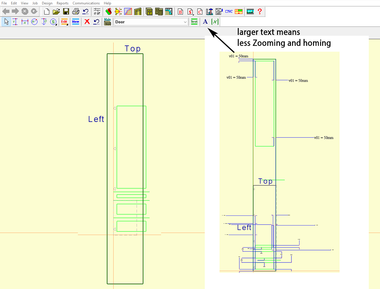

Re: Door Issues again
Hi Nicholas.
Definitely do as Scott Mashburn has suggested.
You can create doors in the door designer and save them with the constraints for use on multiple cabinets,
or edit individual slab doors from the cabinet / assembly editor and save that unit as a one of design.
I looked at the (problem has not occurred unit) and as Scott indicated there are no constraints.
Once a cabinet starts glitching, there is generally no rerun, so just bury it and start again.
Not trying to teach you stuff you already know.
But just some things I have slowly learned that may be useful.
Use formulas for doors like that with multi panels. the formula H/2+30 or w/2-30 for example is very useful.
Constrain internal patterns from those points so they float with the resizing.
Try not to over constrain, over constraining mightn't show up until you want to resize a unit. (Cabinet locks can help with this.)
Multiplication and division are performed first so put them in brackets or at the beginning of the formula.
Resizing the text can cut down on Zooming and homing on large panels.
If you cant select a point to apply a constraint, Hold down the ctrl key and drag out are square to zoom in. You can do this after selecting the first point.
Constraint manager Global Variables [X] button at the top of the CM is really useful for doors like the one you have designed there. If you want to change , perhaps the style width for example.
Change that variable and they all change.
Thats a few of the top of my head.

Oh boy, that still didn't fix my problem, did you try this on your computer? maybe I'm not grouping it properly?
But also It could be a problem with the Dbx inside, I don't have this problem often but it always occurs when attempting to go to part editor or constraint manager and the physical door changes it's shape, any other ideas? or should i get in touch with a programmer for Ecabinets

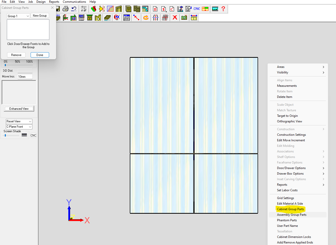

I'm not sure if you are trying to match wood grain and cutting the single door into drawers and door on a panel saw or sliding saw after machining? are you aware of the group door and drawers function?
Right click in the cabinet editor, group the pats and they nest and cut as a group, It could be a lot simpler than developing that door if they can be put on individually.
Just a thought. :)

Oh boy, the file that looked good I sent to the machine but it seems there was a bug, any solutions? The profile just crossed into the other door and gave an error x axis out of bounds
