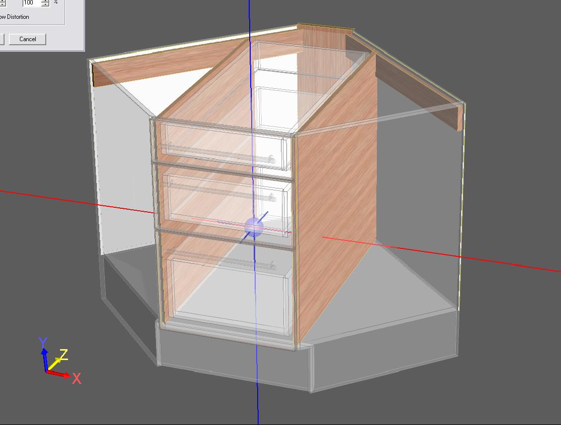

Something I did last year
Post by Mark Rheeder »
And I still haven’t taken a liking to it a 100%. Too much material goes into it, and it’s a bit labor intensive as well.

Michael Yeargain
Location: South East
Post by Michael Yeargain »
Mark Rheeder,
Can you do that in a corner front cabinet? What you have looks great but I think they are looking for a corner front...
