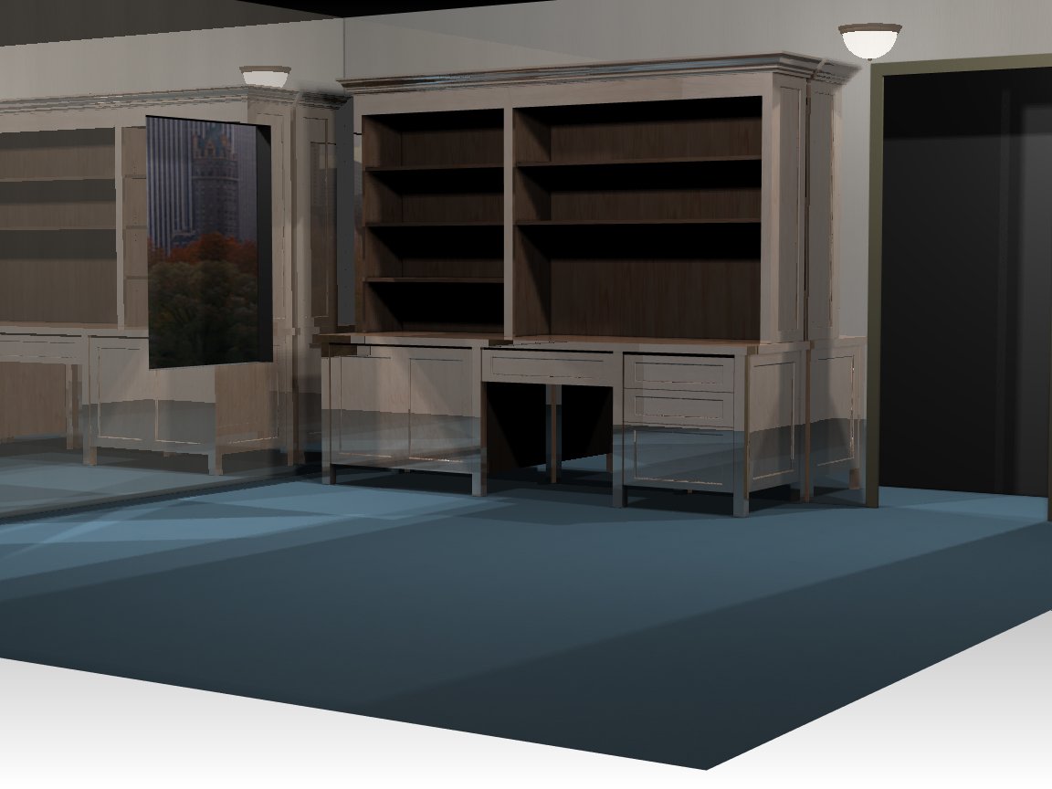

Anyone have any thoughts on why this happened?
Getzler Desk Reflected.jpg (80.97 KiB) Viewed 6496 times

Joseph in presentation view set shine to no more than 5. If you still have too much reflection on some items set it lower click your mouse on that item (you will see a red dot appear) and click render again. It takes a little getting used too.

Tom is right. You have to click on the part that you have a problem and set your reflexion to \"0\" and than it will be ok. I did get this problem also in the past...

Hang tight Joe, V5 is on the way. A lot more control on shine & lighting.
