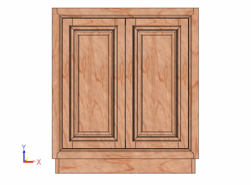

I am currently using another software and want to make the switch to ecabs. I am willing to make the trip to Dale, for training, but I have the following question: Does ecabinets support beaded face frames with inset doors? The beaded/ inset is about 30% of our custom work. I would not want to dive into a new program if it does not support the type of work that we do.

Is this what you're looking for?
Threw it together in a few minutes in eCab.
The stiles of the face frame may be edited to contain any kind of cut you may wish to make on the surface, since eCab allows you to create your part cutting tools as well as providing a selection of pre-provided tools for making custom decorative cuts.
The inset door is made by filling out the specs in the door definitions.

Thanks, 8 was concerned because with beaded frames, the frame parts have to be haunched which affects the legnth of the adjoining piece. My current design program will not do this and my cutlists come out wrong.

Gordon,
You will have some difficulty with the haunch cuts in eCabinets also. All face frames are basically shown as a butt joint. There might be a way around it but I have never really looked into it. There is a mortise and tenon joint feature for face frames that has never been implemented that I think will let you do what you want if they ever get it turned on.
The inset doors of course are no problem at all.
I overlook the haunched cut. You might be able to do this in the part editor otherwise you can create the face frame using display boards and edit them in the display part editor to get the haunch and bead.
Dan, Gordon,
I just played with it a little and by adding a negative inset to your rails and midstiles etc. you can allow for the haunch cuts on your cutlists so Gordon yes I think eCabinets will do what you want.
You can even show the cuts graphically if you want to go to the trouble.

This is what you are talking about right?

Here is that cabinet if you want to take a look at it. I used negative insets like Kerry said to extend the top and bottom rails by one inch on each end.
Then I took each stile into the part editor and cut a 1x1 inch square on each end then cut a 1\" one dimension chamfer on end.
I took each rail into the part editor and cut a 1\" one dimension chamfer on each end and that was it.
Total time--five minutes at most. It took a lot longer to describe it than to do it :lol:

Okay, I had to play just a little more and put a bead (single) and inset doors on the cabinet for you Gordon.
Haunched Frame.jpg (60.21 KiB) Viewed 37024 times
Hey Dan, try a inset mitered door with a bead detail on that cab to see what it looks like.
