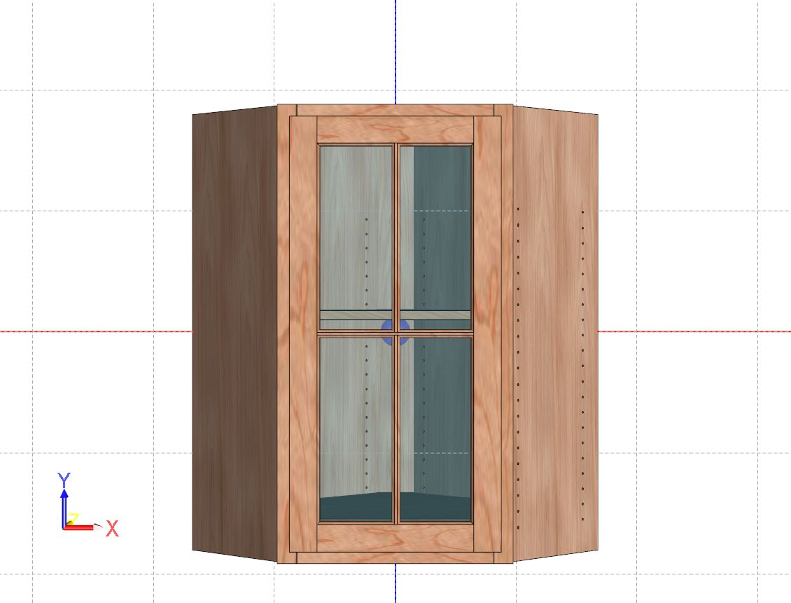

I know from reading various posts that we've had some problems with shelf holes...this is one I ran across this morning.
For some reason it is only the right side that has the holes on the wrong side of the sheet. Dados are correct
Any help out there or is this one for the list?
Mark

by Mark Taylor » Thu, Dec 21 2006, 2:08PM
Okay...now get this
the illustration shows the holes on the outside of the cabinet, with the dados being correct on the inside of the cabinet.
When I nest the cabinet (in ecabinets and/or on the router) the dado's show up as the flip op - not the holes.

Are you using a different material for the side--a single sided material maybe?
Did you do anything else to that side, like part editor cuts or anything?
I know the answer to both of these is probably no but I'm just grasping at straws to see if I can figure out what is happening.
Post the cabinet so I can look at it.

Dan - you're right...no & no here is the cabinet
WDC2436.hsf
(736.26 KiB) Downloaded 2201 times

How did you do the shelf holes?

by Mark Taylor » Fri, Dec 22 2006, 9:51AM
On my uppers, I always add the first shelf with shelf holes - leaving no holes below and adding 20 +/- above depending on the size of the cabinet. Then I place the shelf 1.25\" from the deck. Balance of shelves, if any, are then placed without holes.
Is that what your looking for...?

I figured out what happened--it is the old face frame bug with a new look.
Turn face frames off and back on then add your door back and it will be okay.

Actually Dan it was the scribe on the face frames...followed your instructions - except I added my usual 1/4\" scribe to each side and the holes were still there. Went back in and took the scribe out and the holes disappeared....
why only the right side and not the left?
Any further suggestions?

same thing worked on the original cabinet - simply remove the face frame scribe and the holes disappear.

Try turning off the \"Miter face frames\" option since you are using a scribe. The miter option moves the stile location somehow and may conflict with scribe settings.
