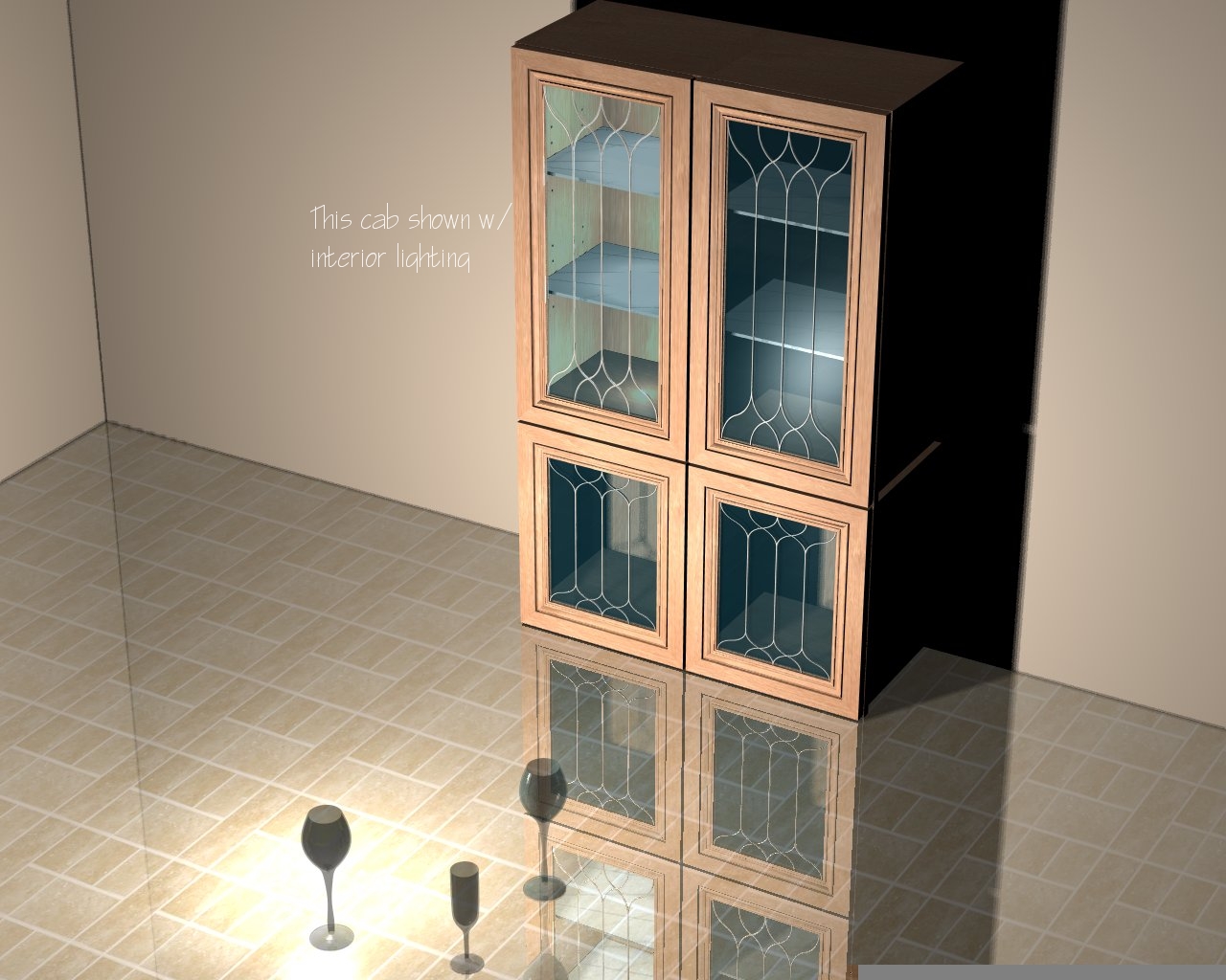

Why does display objects representing glass show up so dark?
Note the wine glasses on the floor.

Keith,
Take your wine glasses into the display Part editor and change the RGB color of the glass to something lighter. the lightest is 250, 250, 250,

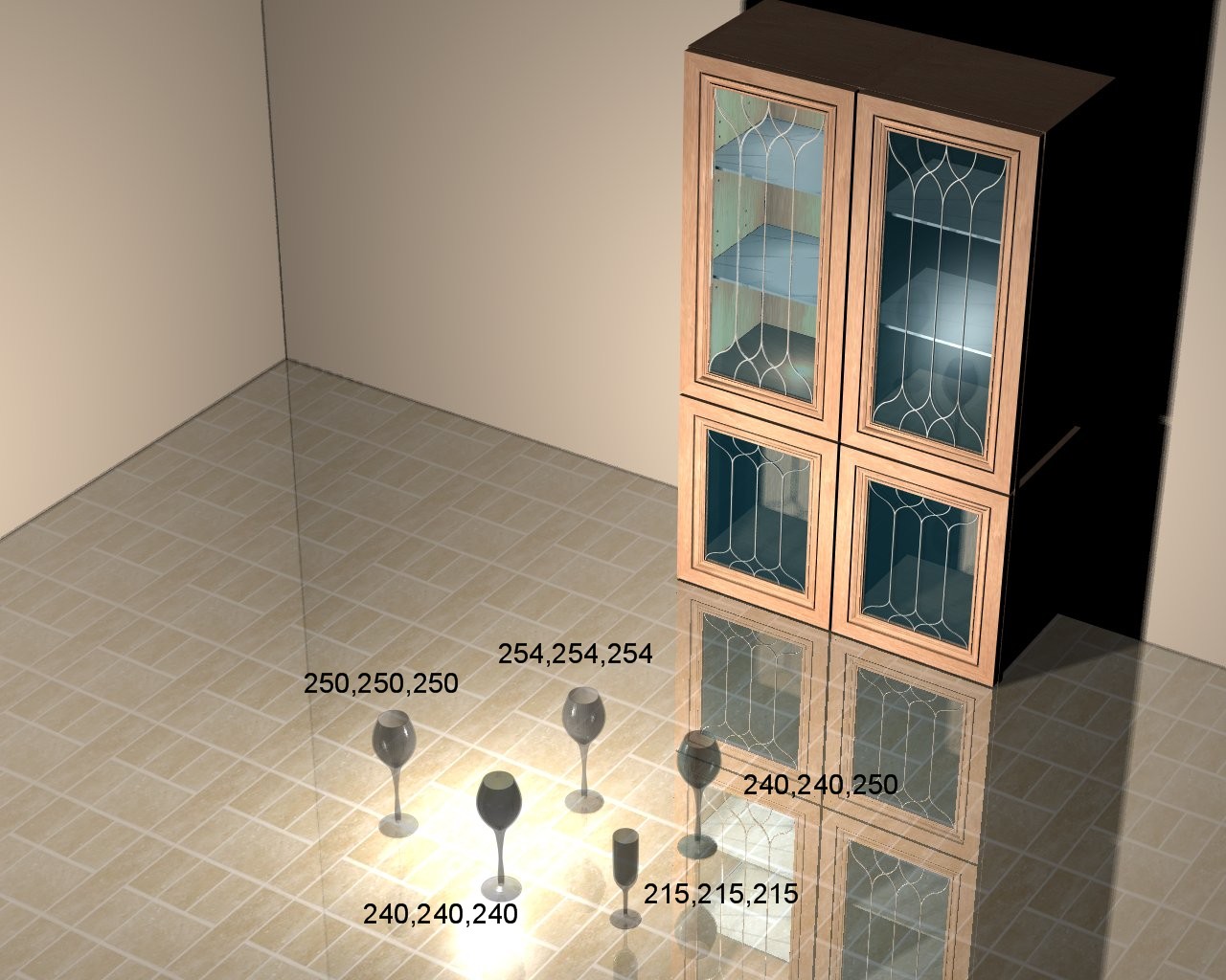

Hey thanks Kerry, but this is what I am getting. Is this the best I can get?
This is not a critical issue, but I would like to know if I can improve any presentation skills.

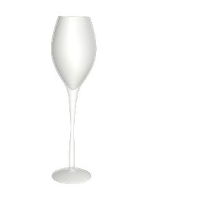

Do you have the \"Transmission On\" checkbox checked?
Here is one that is 210, 210, 200 with transmission on and gouraud rendering.

Sure do! Yours looks better!

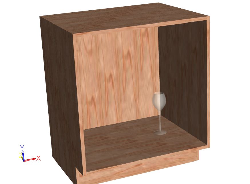

Here is the glass itself.
wine glass.hsf
(58.3 KiB) Downloaded 919 times

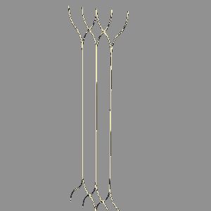

What you are seeing is a display object I created in a separate 3D modeling program and converted it to an .stl file that eCabs will open in the Display Part Editor. In the DPE I added a material and saved in as an .hsf file that i used in the Cabinet/Assembly editor. I was trying to represent a cammed glass insert in a cabinet door. Attached is the file of the camming if it will help.
-KB
