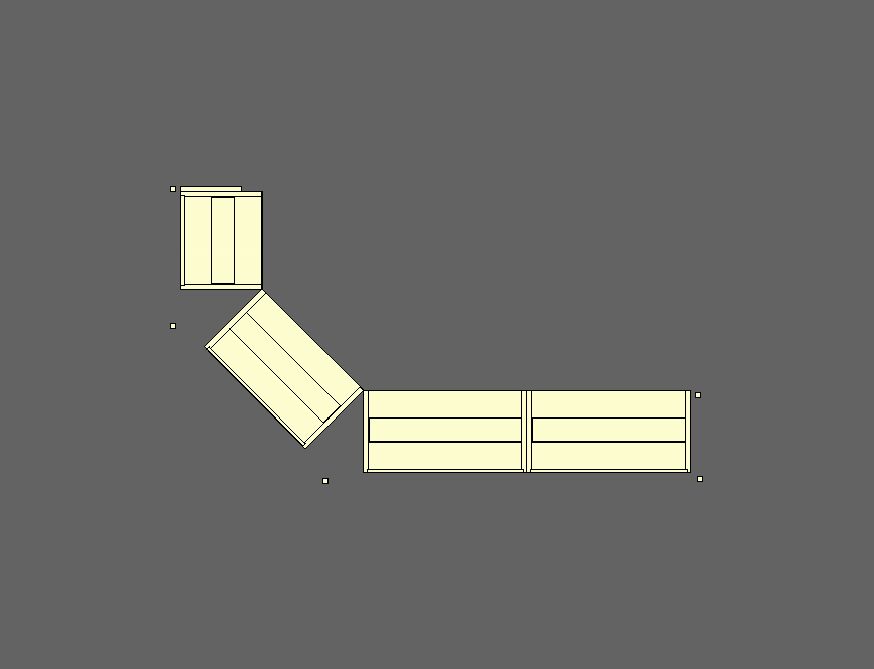

Greetings,
I cannot seem to correctly add a countertop (in the standard fashion from the detail room screen) to the the attached bar base aeembly.
It appears that the countertop creator will not select one of the corners, and instead wants to select what appears to be the outside edge of the toe kick or base molding.
I have tried disassociating all display panels, toe kiska nd moldings from this all base cabintes, but this does not colve the problem. Can anyone suggest another reason why the corner cannot be selected?
Thx
Base v4.esa
(1.35 MiB) Downloaded 1068 times
CPS

Prior to seperating the association between the toe kicks and the cabinets...Yes. I selected the 40.75\" altitude and carried on, but it still goes to the toekick or molding edge, I cannot tell which.
After the disassociation, I do not get that dialog box. But you can still sort of tell where the selector is, based on wheter you can see the whole selector (becasuse it hovers over the top of the cabinet) or a portion of it is obscured (because it is selcting an item below the top of the cabinet and the top partially obscures the selector).
It is the left most edge on the inside of the angled cabinets that I'm having trouble with.
Thx

Mike,
Thanks for your continued interest. The bar base unit is an L or J shaped one except that the corener is formed by a standard cabinet alighed 45 dgree to it adjacent cabinets. A corner cabinet could have been used I suppose, but this is not what the customer wanted.
The base cabinets are defined as having a detached toe kisk w/ a 4\" height. These toe kicks have 3/4\" blocking applied around the outseide perimiter so that the applied base molding lays on top of the diaply panels applied to the outside (back) of the base cabinets.
The base unit is attached here.

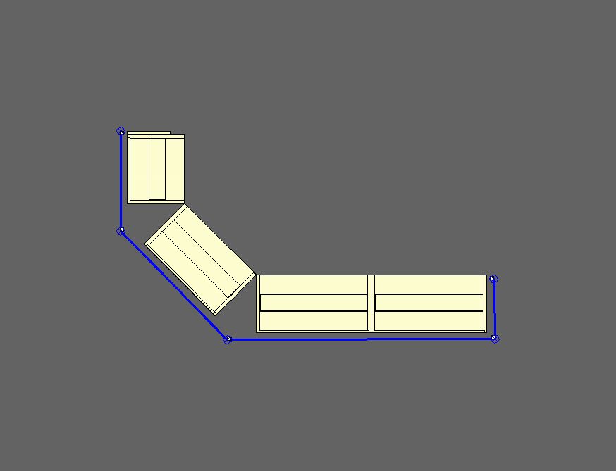

Now I'm following, here is a trick out of \"Kerry's Mind\" Attached are pics. First in cab ed make a cabinet 3/4 x 3/4 nothing but one side should remain & it's 3/4 deep (make sure you change the cab width to 3/4 as well) Then save as FPO (for position only) the height can be changed like any other cab. Place your assembly in a room, then place these FPO's at your angles or any where you need a top to go. Hope that helps.
