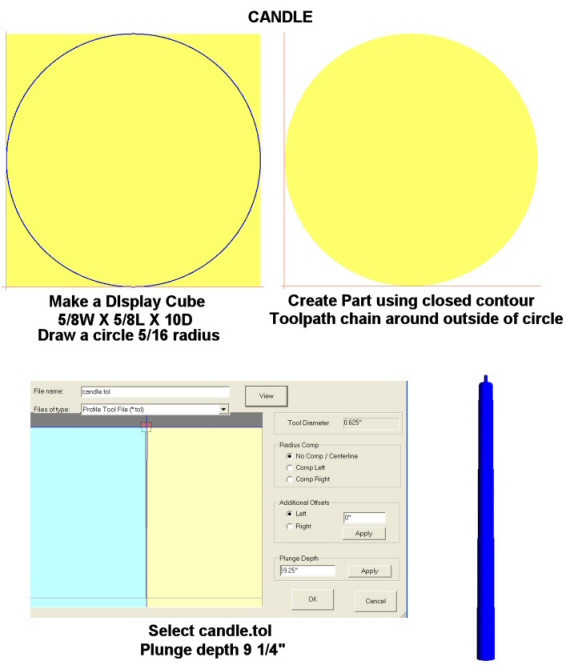

Nothing special about this one but it does the trick. The zip contains the tol file and the x_t file.
