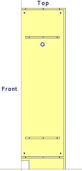

This is what we have been doing on this cabinet. We created a dxf file to locate the screws. I saved the cabinets without the holes in case we wanted to change anything. When I get ready to add all the holes I just loaded in the template to add the holes all at once. The dxf file is easy to edit if we decide to change the hole patterns. But I don't know if I would want to do a lot of different cabinets this way. I does take some extra time. This is a cabinet that we a cutting many of so a little extra time on the design was not a big deal.

That is a clever solution....
Can we make the DXF file in e-cabs?
Do you do that with Blind Dadoes also? If you do why not just staple em?
Very cool
Wood Butcher/Case Maker

You can make an x_t file of your hole patterns in eCabinets and save it. Then reload it on another piece if you want.

You mean like doing hole patterns for hardware?
You can save ANY part editor design as an X_T tool file. If you create the same cutouts repeatedly on parts, save the design and reuse it.
For example, I use this feature to create cutouts on leg bases for my armoire-style entertainment centers. I also use it for creating non-rectangular cutouts in display panels that I use as the rails and stiles for panel doors.
