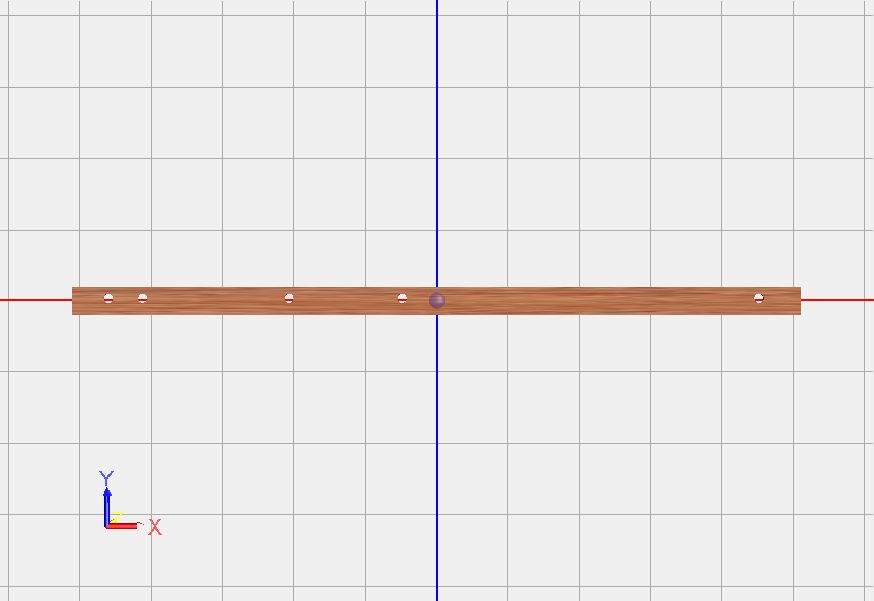

Need to cut a seried of pieces like this for a large project....I made it using the display panel and display board function(tried it both ways)...but it will not nest...
I was able to create a TWD however when I went to the router to get it cut there was nothing in the file(or control nesting didn't see it) whatever the case it isn't getting cut as is...

Sorry the dimensions are
4\"x102\"x 1/2\"
the material to be cut is red oak

hee is one of the parts

I created a twd from the file you've supplied and I am also unable to see the part on the Load (Control Nesting) screen of Control Nesting. I then decided to redraw the part myself, using a display panel listed as 1/2\" thick material and the same dimensions you've supplied, and was able to load and nest the part I created. In order to verify that this situation is not a Control Nesting issue, I reverted back several versions to verify both files(yours & mine).
I would suggest that you ensure your running updated version of eCab and redraw part using display panel approach. Keep me updated on your progress and I'll continue to research this issue.

when you created the twd...did you do it from the cabinet design editor? after editing the part.
using the little button on the bottom left
I tried it as a display panel(also as a cabinet side) and it would not nest in e-cabs.....does that mean it won't nest at the machine?
I will get with the CNC guy and see what version he is running; althoug I do remember him saying that he was uploading an update about a week ago...
Thanks for your time...

I did create the twd directly from Cabinet Editor (CNC button at bottom lft.). I also placed part in room and saved as job to write cnc that method with good results here. Nesting in eCab is similar to nesting at machine, but they are different software entities. At this point, this doesn't seem to be a control nesting issue, as I stated, I've reverted back through several versions to ensure I got same results as I'm seeing in current version (5.18).

We got it to nest, but it nests it with outline cut which we cannot have.
The material that we are going to use is same size as the finish product.
Can this be done on the CNC??? If it can how?

This can be done using the Scrap Part Recovery option in Control Nesting (LOAD Screen). Then, to omit the Outline cut, you will need to go into SETTINGS and select the option \"No Outline Cuts\" (To the rt hand side of settings screen). Of course you will have to place one part at a time to machine. Machining finished parts has just became an option within the last few releases of Control Nesting.
