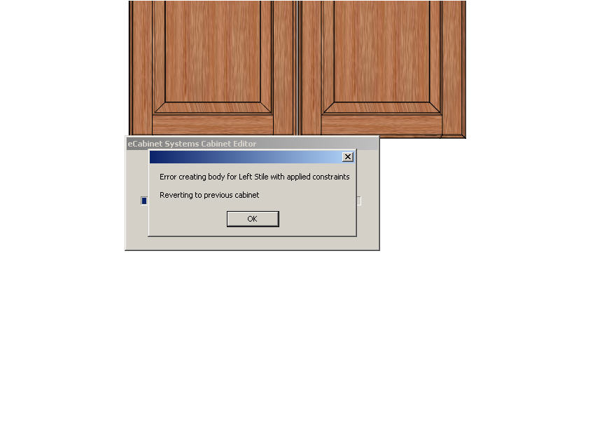

When trying to add CRP-10 double doors I am getting the error in the attached image.
Error Adding Doors.jpg (43.8 KiB) Viewed 6439 times
Update: I removed all part editor cuts from the cabinet and was able to add the doors. I was then able to put part editor cuts back on the cabinet.
Additional information: The CRP-10 doors we configured with a C profile and were inset into the face frames.

Can you please post the cabinet the way it was when you were getting the message? Thanks.
I don't have it anymore but if you try to remove the doors from this one you will get the same error.

What kind of parte editor cuts did you have on the cabinet and where?
This cabinet has all of the cuts on it. The top has a profiled edge, both ends and both face frame stiles are raised using MDF assymetric #4.
Removing the cuts did not help though until I saved the cabinet WITHOUT the cuts. Once I did that I could add the doors and cuts back to the cabinet.
