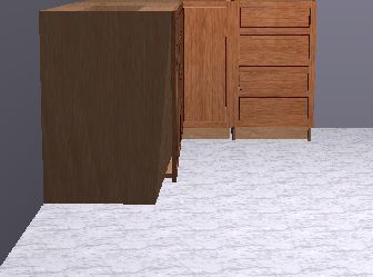

I am a new user and when I put my cabinets in a room layout all of the toe kicks got these weird angles on them. any ideas?

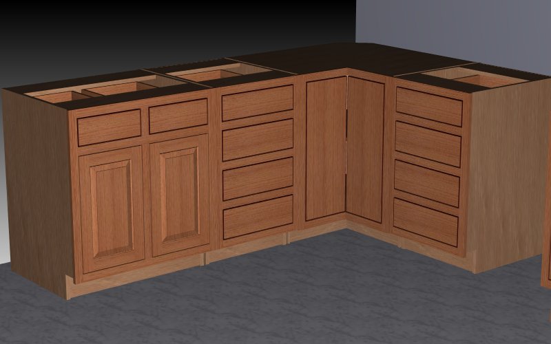

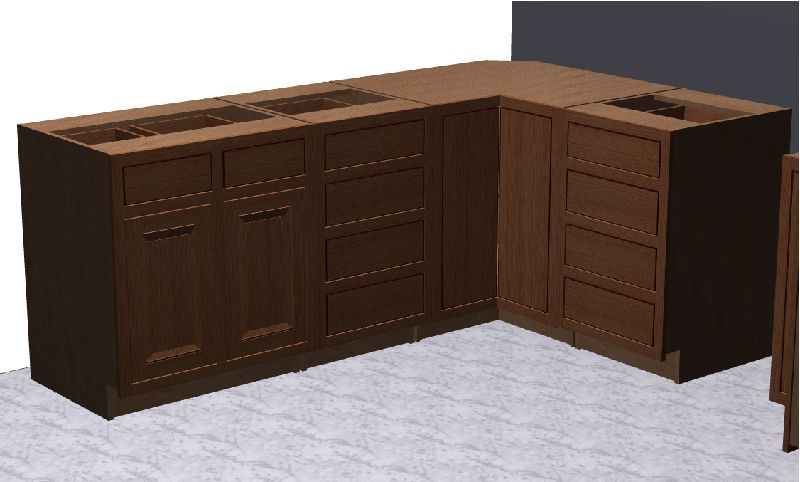

After downloading your room I have confirmed my previous post.
Here is pictures of your cabinets - with and without the Enhanced View button.

Lyndon,
Paul was exactly right! I have attached two files:
1. The room, with Enhanced View selected
2. The same room view, but rendered.
Your toe kicks are perfect!
