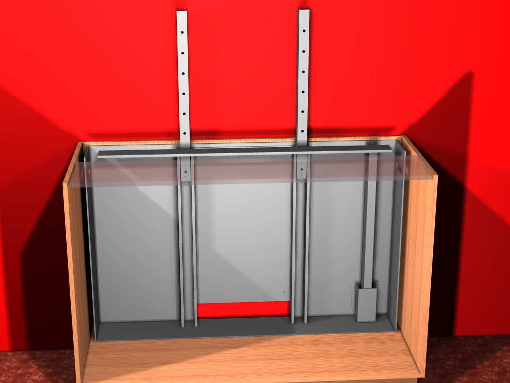

Hi Jerrod here is one I have been working on
TV cabinet is this what you talking about
TV Left in back
The left is a STL flie
TV L eft rack.jpg (75.5 KiB) Viewed 5867 times

does the lid on your entertainment center move with the lift. or does one manually open it? i like your design it is very creative.
Hi Jerrod That is the plan I am not shore if it will work
