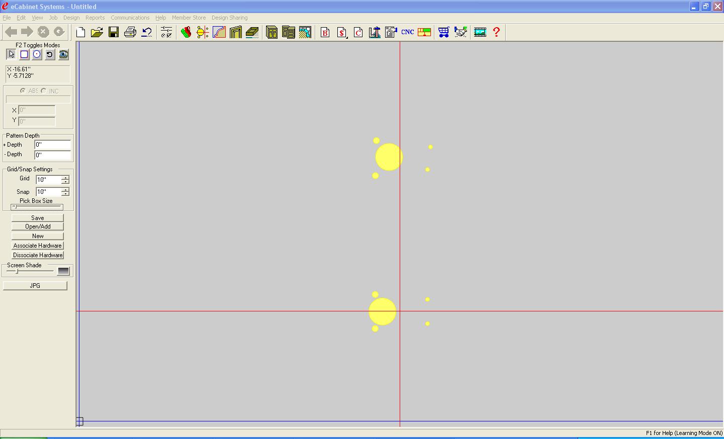

Our dealer training is finished and the Turkey dealer (Tervelli Ltd. Sti.) showed me how to add 4 hinges automatically. Some members might know about this allready but for the ones that don't, this might be beneficial.
In the Hardware Hole Editor, you will need to add two sets of hinges. However the distance between the two will be fixed (first picture).

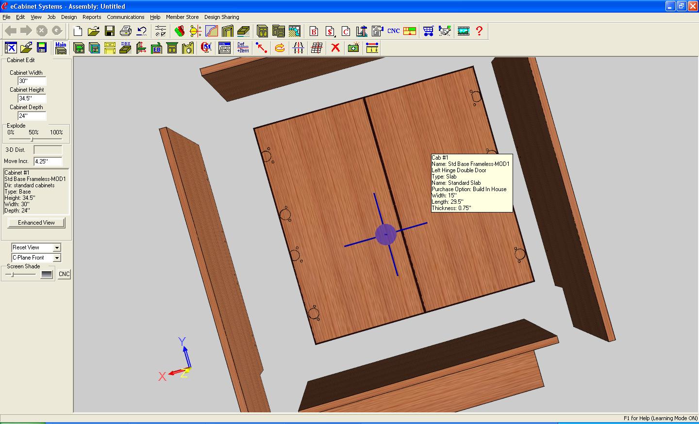

Then once you add the hinge to the door you will see what the second pic looks like. The bottom hinge placement is the same as before but the top hinge placement will require a bigger number in order for it to work.
Hope this helps
