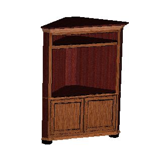

any ideas why? also, the top faceframe opening doesnt recognize all the rails in the ff editor.

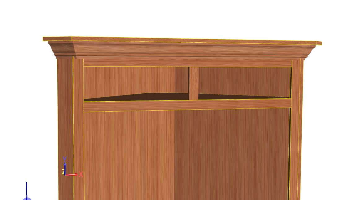

In the Face Frame Editor I deleted the second rail from the top, and NOW the two (small) top openings work as expected.
I am not sure, but I believe that corner cabinets forbid the creation of partitions, and center stiles. I hope others will let me know if I am wrong...
I used a display board to add a stile in the top opening - see the image below.
Al
Center stile in corner cabinet.jpg (71.85 KiB) Viewed 12671 times

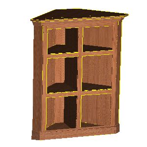

Is this the idea?
Post by Al Navas »
Kerry,
I wonder if this is getting close to your suggestions? The dimensions I used prevented me from using fixed shelves.
I appreciate any and all input. Thanks!
Al
Corner Cab with Face Frames.jpg (15.49 KiB) Viewed 12547 times
Corner Cab with Face Frames.zip
This assembly can be resized - can also add partitions and shelves
(309.41 KiB) Downloaded 515 times
