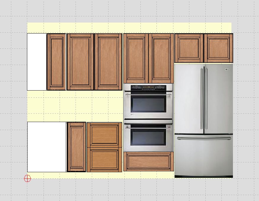

I don't like to associate the oven or whatever with the cabinet. It is much easier to select and move if they are separate. Here is an example... I just looked up the part # and downloaded the image and added it to a cube that I placed in the cabinet.
