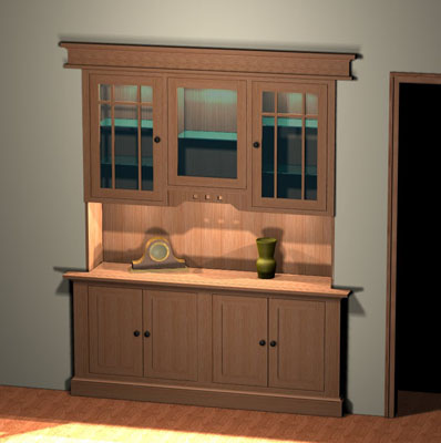

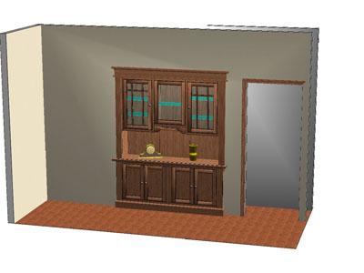

Now I have a strange occurrence..those side moldings appear in everything but the final rendering. I have attached the \"before\" and \"after\" photos.

This is what it looks like before rendering
This is what the rendering looks like.
