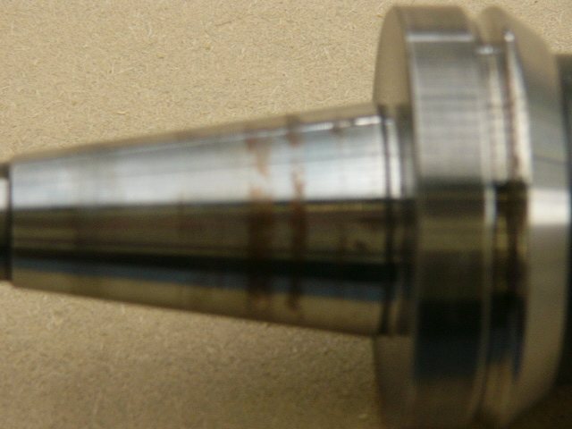

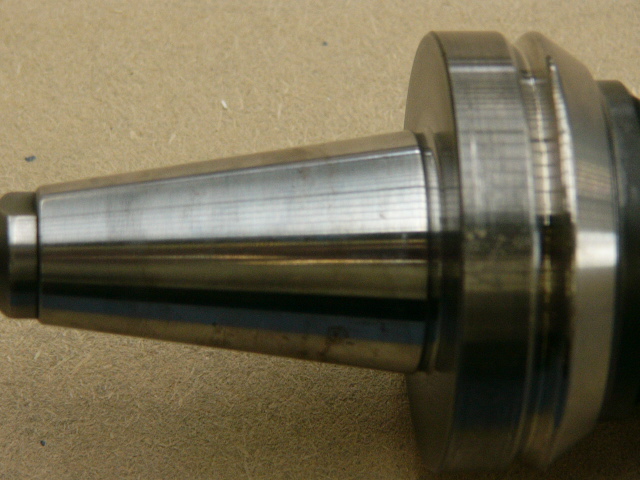

I might of spoken too soon!!!!
Im now getting the brown build up again.
I got pics 2 show u.
And one one of the pics you can c the little dents that are on the holder!
The thermwood pushed it though the holder again as well.

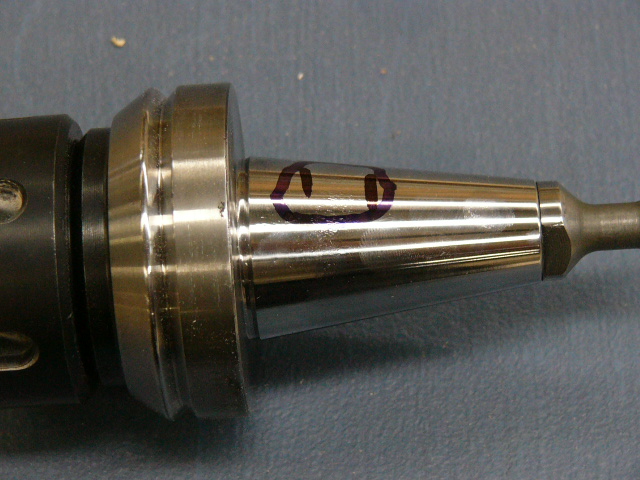

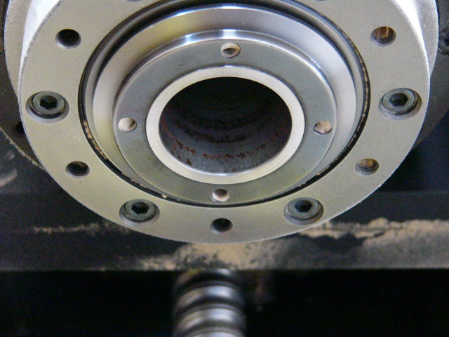

Post by Thom Davies »
heres another pic
