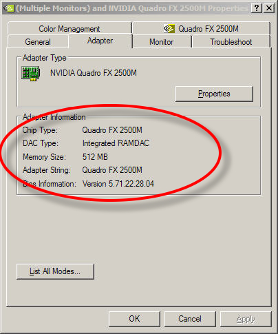

I believe the 16X is just not available while the Tweak Utility is installed. The image below shows what I get when it is not installed, and I select the card's Advanced Settings:
Al
Quadro FX2500M graphics card.jpg (115.55 KiB) Viewed 10544 times
I think I found the real answer Al (emphasis mine):
2007-Jan-03: Updated to Version 1.0.2.1. This adds detection and correct options for the Quadro FX 2500M found in Dell and HP Laptops. Even though this graphics board can have 512MB of dedicated memory, it only supports 4X hardware antialiasing.

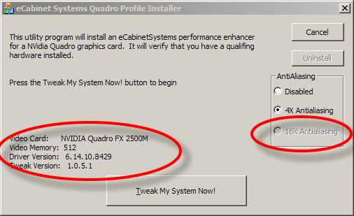

You can see the source of my confusion below - I cannot specify 16X with Tweak 1.0.5.1, as the only options are Disabled, and 4X. I want my money back! :lol:
Dean - Is Tweak 1.0.5.1 supposed to allow the selection of 16X anti-alias?
Tweak 1-0-5-1.jpg (111.74 KiB) Viewed 10519 times
Read my earlier post Al...the Quadro FX2500M (and it looks like all of the mobile series) do not support 16x, regardless of whether they have 512MB pr not. This is from one of Dean's posts to the Quadro Tweak Utility thread.
