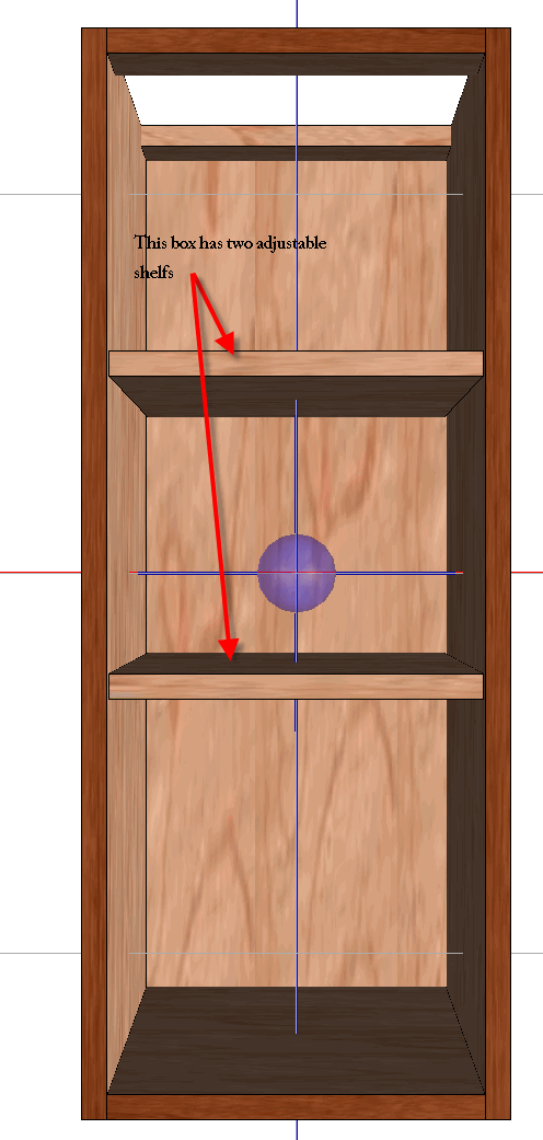

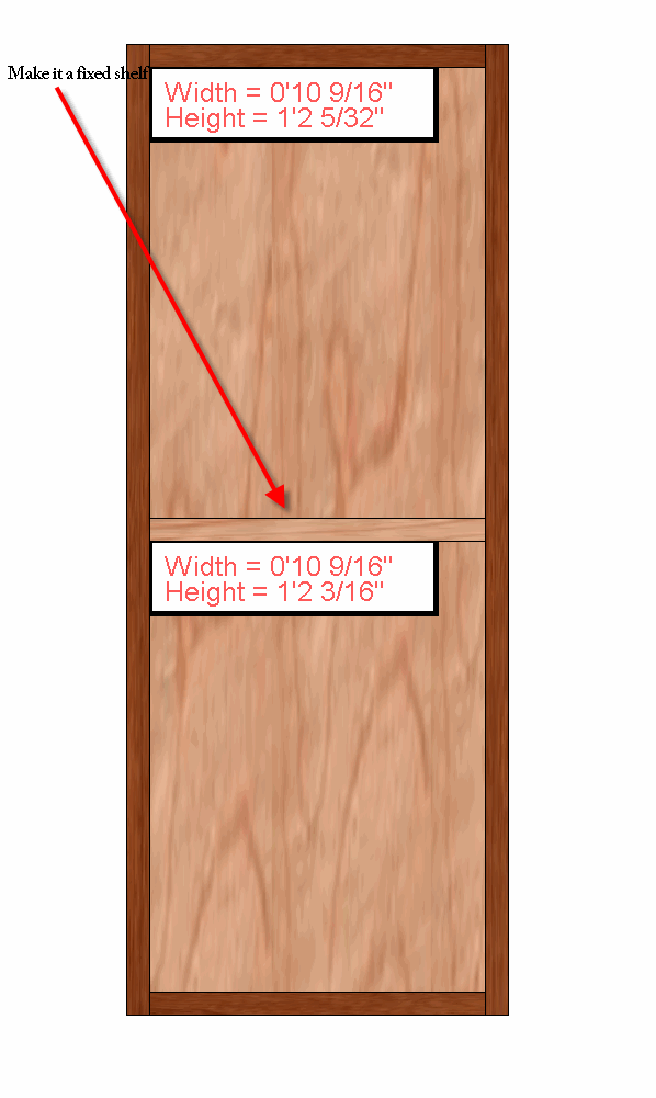

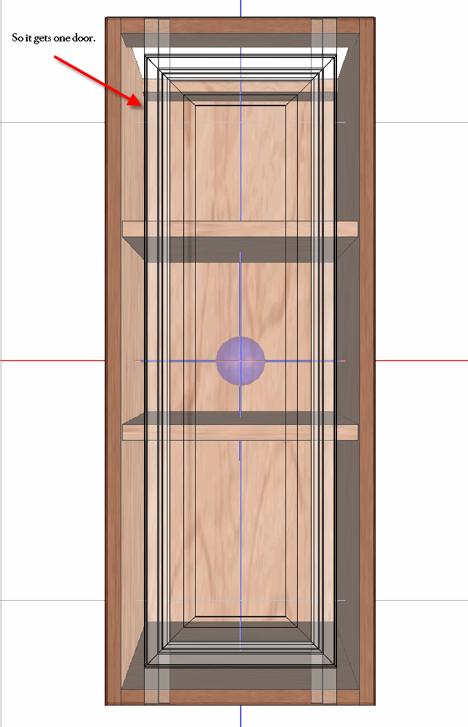

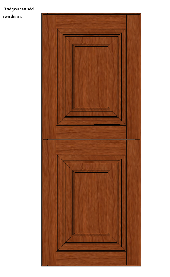

You need to give the software a defined boundary for where you what the door to be. If you have a cabinet with a fixed shelf in the middle, you can place two doors on it. If the shelf in the middle is adjustable, the software will only put one door on the whole box.

Pic's
Post by Joseph Fusco »
gaynelle,
take a look:
Joseph Fusco
Posts: 71
Joined: Tue, May 17 2005, 2:19PM
Location: Staten Island, NY
This is the first pic.

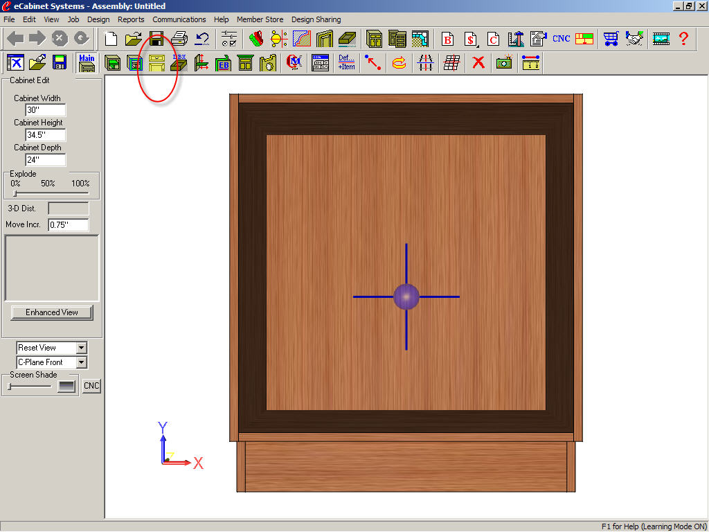

Can you attach the assembly file, or the cabinet that your having trouble with?

Glenn Van Reason wrote:Can you attach the assembly file, or the cabinet that your having trouble with?
like this????

No that is just a picture of the cabinet, I need the actual hsf file of the cabinet so I can open it in eCabinets and try it out
