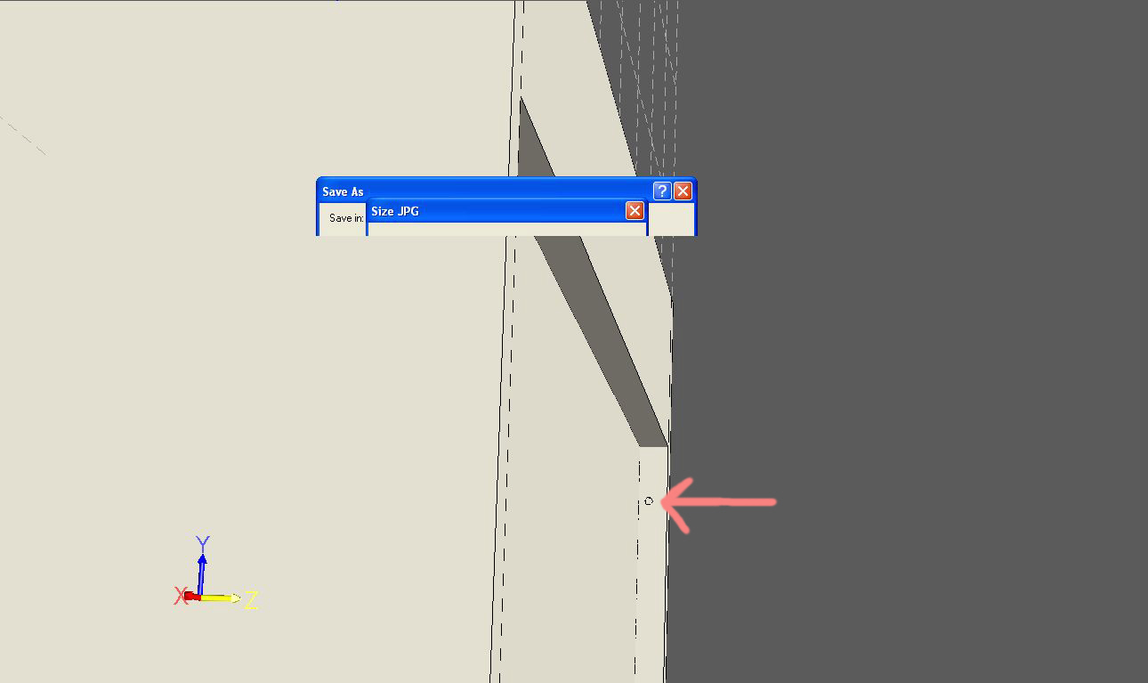

We recognized this would be a problem early on so our solution was to put a 5mm hole 2 mm deep on our cabinet part sides to designate the top of the part.
