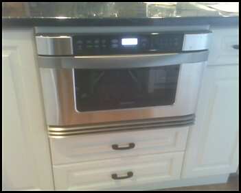

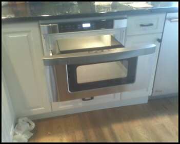

Post by Gene Davis »
These Sharps are nice, but pricey.

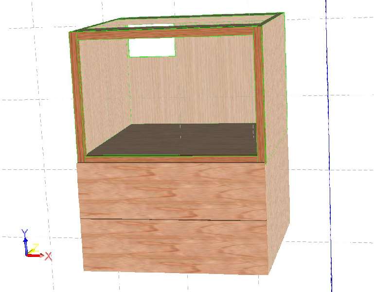

I thought you might like to see how one looks done in a frameless arrangement. The cab housing it is a faceframed box with depth 3/4 less than the drawerstack box underneath. The cutout in the back is per Sharp's spec, and is for the wall receptacle.
Sorry about the quality of the photos, as they were taken with my phone.

:beer: Nice job and your phone pics look good to :beer:

How much overhang did the microwave have over the frame?
What was the opening and frame size?

Here's one that I did.
sharp microwave drawer.pdf
(360.68 KiB) Downloaded 867 times
