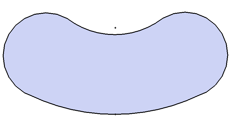

Alan,
Is this the shape you'd like to archive?

Thanks for all the replies!
Dan:I do not have a CNC machine...I would be cutting out the parts by hand. Right now I just need a 3D full-color rendering for presentation.
Joseph: Nice work! That is exactly the shape for which I am looking!

Joseph Fusco wrote:Alan,
Joseph,
That's exactly the right shape! Nice job!

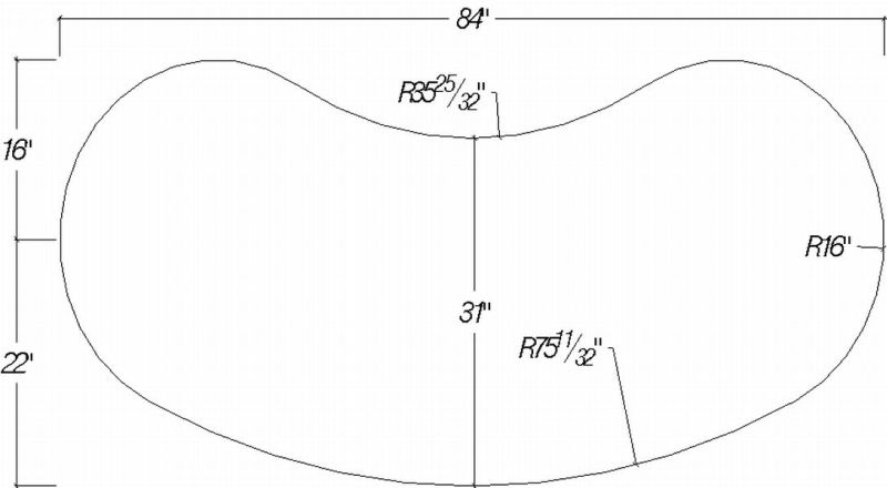

Post by Mike Brannon »
This layout was easy to do in AutoCAD. But AutoCAD is not very good for presentation drawings, unless you mean 2 D plans, sections and elvations as might be required as submission to an Architect on a commercial job.
