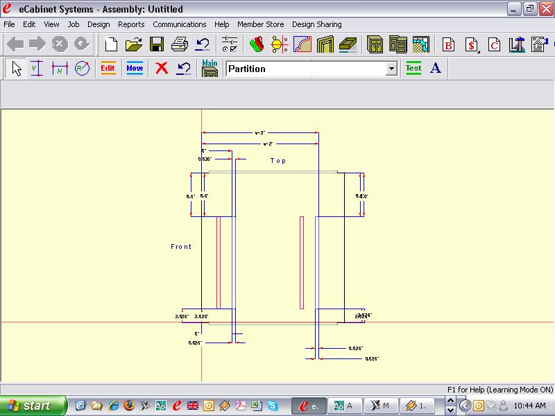

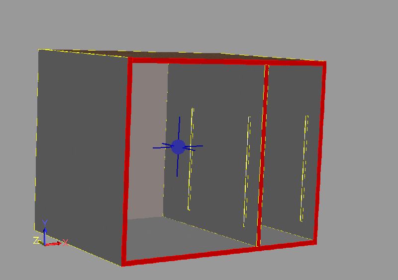

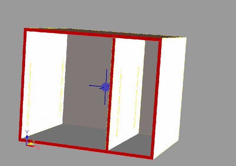

I was hoping to get some help or suggestions about a certain problem I encounter in Constraint Manager. We have those kind of cabinets that instead of shelf holes have pilaster channels in them. I end up creating a 3/32" deep croove on the gables of the cabinet and then adjust all the spacing in Constraint Manager. If I need to resize the cabinet in depth or hight everything works great on the gables but the partions turn into mess. Because I have pilaster grooves on both sides of the partions the dimensions when I change them to be the same on both sides actually mix up and only snap on the groove on one side. It seems that it's not really possible to put part editor cuts on both sides of a part that are symmetrical the constraint dimensions even though applied on both sides after resize seem to get mixed and not appear properly after a change. Anyways I have attached some pictures of what I mean. It's not the first time I encounter it but I decided to see if there's a solution. I can work around it and create new cabinet with new depth or hight but part of Constraint Manager function is to save time in resizing so if it's not my fault may be it needs to get fized. Thank you

I dont know how to explain it. First I create the cabinet to the specified dimensions and then I pick the partiotion and go in part editor. I pick a rectagle from the menu and cut a pocket at 3/32" on both sides. You can flip the part in part editor. Form there I go to constrant menager and start adjustng the dimensions. At the end the grooves on the partiotion on top and bottom are on top of each other.
I am attaching my base cabinet from different area of the same project. Please try to resize it to different depth or hight to see what my problem is. Thank you

Re: Constraint Manager Help/Bug
In the image you attached, you do not have constraints on the grooves on the back side of the partition (the pink lines). I just created grooves on both sides of a partition and constrained them. They worked perfectfully when the cabinet was resized.

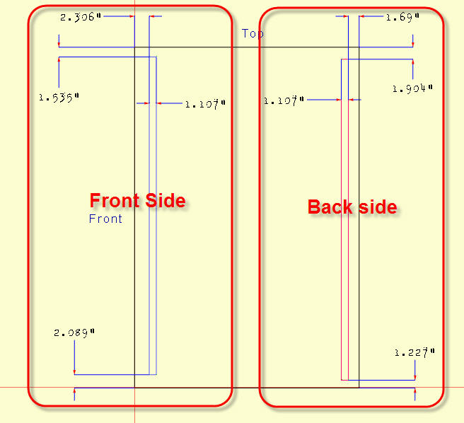

Constraints need to be on both sides of partition like the image below. This partition only has one groove on each side but the process is the same.

I do have constraints. When I resized the cabinet u can see how the constraints stayed with the top side only. That's why there are two constraints for each grove on the top part - the blue groves. I wouldnt put two of them on for the same cut. When the grove constraints are placed on top of each other(equalizing all the dimensions) and you try to resize it that's what happens - at least with me. I tried to clip the dimensions on diffent corners of the groves for top and bottom but when resized the constraints always reffer to the top groves only.
Dann, try this. Make pilaster groves at .625" wide, 3" from top and bottom, 2" from the front and from the back on both sides of a partiotion on any cabinet. Then resize it. Tell me what u get.
You're right...it looks like something weird happens when the grooves are in the same location on both sides of the part.

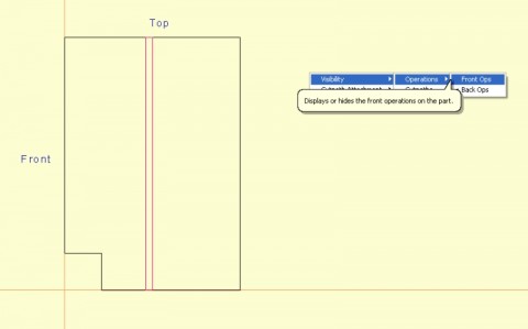

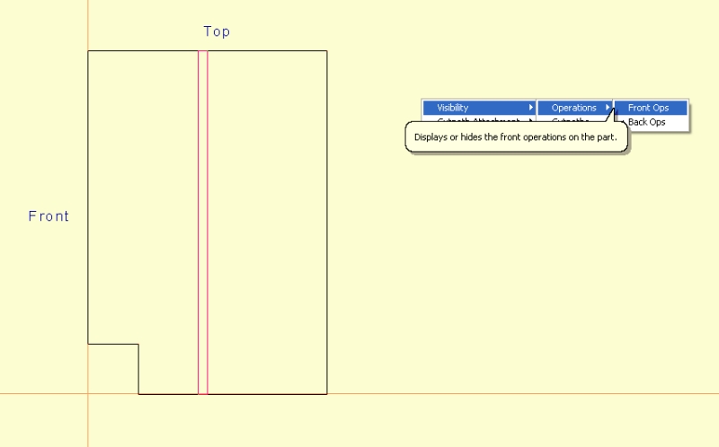

Steve,
With your part in the constraint manager
Right click then choose visibility
Then Operations and check or un-check Front Ops or Back Ops to see one or the other.
Add the appropriate constraints to each,
Front Ops will show as blue lines
Back Ops will show as Red Lines
