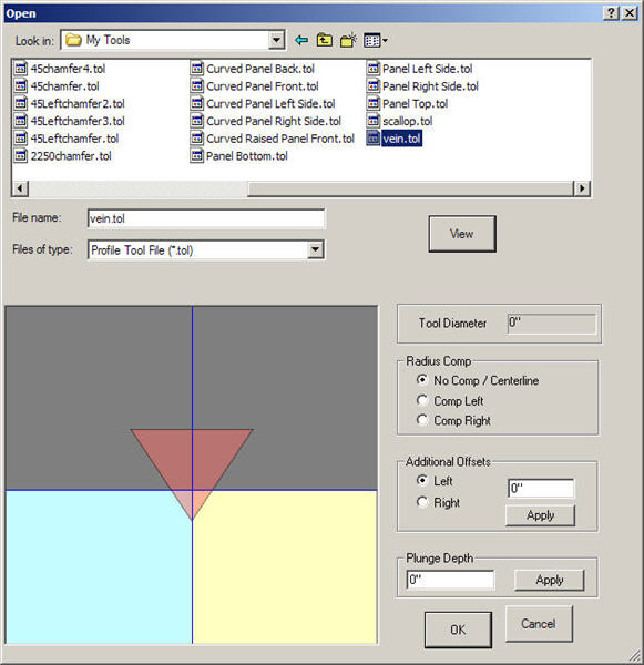

It is very simple to make a v-groove bit for the Part Editor. Just create an inverted triangle in the Shape Manager and save it as a tool (.tol) file.
To use it, place lines on the part to be grooved and profile (single path) using the tool you just created.

Dan, do you rotate the triangle to the left or right?
Damon Nabors
Re: V-Grooving....
Neither...
Notice the bit is created at the location needed so plunge, offset, etc are left at 0.

K I ran away from this because of other things but now how do i find the inverted triangle or do i make a inverted triangle and do i specify a Tool width????
Re: V-Grooving....
You can make any tool you need in the Shape Manager. I never specify a diameter for tools that I create.
