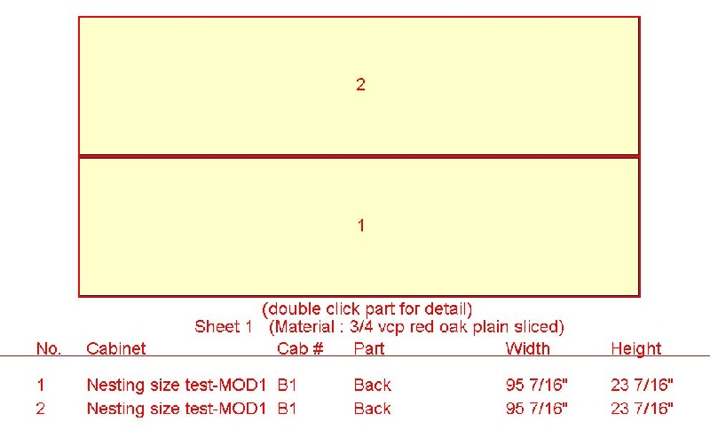

To learn about maxing out my nesting, I created a wallcab with a back only, flush to all sides. That way I have a single part that is readily resizeable as a cab, to throw into a batch for nesting using various sizes of panel stock.
Setting the collar size to zero, I then fiddled with the size, moving in 16ths by width and height, to see what max size I could nest on a panel.
We work in both melamine and ply, and mel panels are larger than what we get in ply. The pic attached shows what I got as a max for a 48 x 96 stock size panel.
It is good to do this as an exercise and then actually cut some parts from sheets, so that you are then set up to build your seedcabs to utilize optomized nesting. For example here, in plywood, our basecab depths are all 23-7/16" so that they can nest two-wide.
