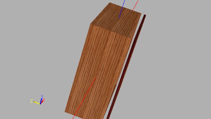

Re: door gaps
Here is an exaggerated example.

Gene Davis
Re: door gaps
Post by Gene Davis »
Thanks for the prod, Kerry, but I just tried it, and it won't work, at least for me.
Took a frameless cab (this topic is all about frameless), went into door/drawer editor, removed the existing pair of doors, opened up the dialog box for all the construction settings, set top reveal at 3mm, sides at 1.5mm, bottom at 0, center gap at 3mm, then set the door inset value to -3mm. Said OK and closed the box.
Selected the opening, and BOOM, in came a pair of doors, with the 3mm boost off the front of the carcase, but none of the edges were overlaid to the reveals specified. The doors appear to have the 3mm "negative" inset, but zero for overlays, i.e., the "reveals" all the way around are equal to the panel thicknesses of 19.4mm. See the pic attached.
You cannot have both an "overlay" door in frameless, and anything but a zero inset.
Unless you know a workaround I don't.

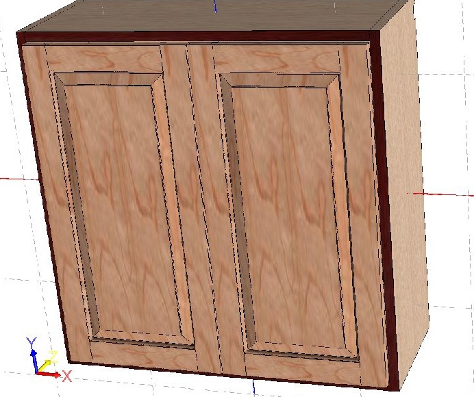

Gene Davis
Re: door gaps
Dang! Forgot to attach. Here's the pic.
Boost the doors.jpg (159.18 KiB) Viewed 21928 times

Gene Davis
Re: door gaps
OK, I reread and see how it works. Sorry to be so obtuse.

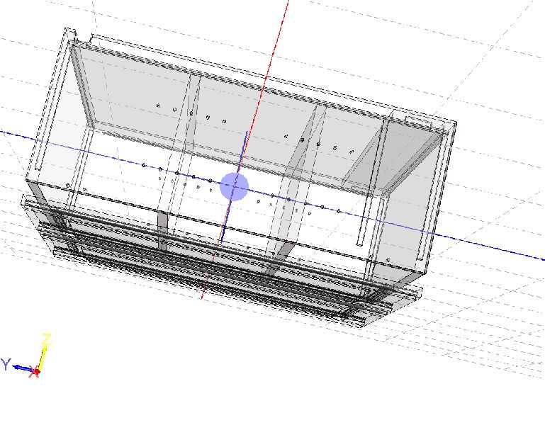

As the door is thus moved, so of course are the hardware holes, which may be a hassle for users that want the door and hardware to behave as the manufacturer designs it, because the 37mm plate mount spec puts the door, with adjustments at zero, at a 1mm offset away from carcase front.
I'm sure not gonna go through all my seeds to both boost the doors by a millimeter or two, and change my hardware hole group setback to 36mm or 35mm, just for this. We're happy just cranking out the hinges to adjust our gaps for the bumper thickness we're using.
Not unless I could do it globally.
Big boost.jpg (92.41 KiB) Viewed 21915 times
