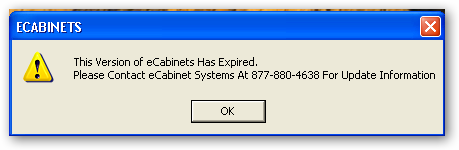

Getting worst now. I uninstalled and reinstalled and now I get this error message. The problem is still the same though...can't run 5.2 and if I try installing it, it says it is already installed. I need major help here.
Ecab problem.png (13.16 KiB) Viewed 18222 times

Rerun the 5.2 update and let it uninstall. then run it again and let it reinstall.

Sorry to hear you're having trouble. So from what you are saying the update ran successfully, but you are not seeing 5.2. It sounds like your virus protection software or a firewall is stopping the update from placing the necessary files. Try this...
1.) Re-run the 5.2 Build 1 update and select the "Remove" option. This will merely remove the update installer files.
2.) Insure you have any anti-virus software applications and/or firewalls disabled. This includes Windows firewall.
3.) Now run the 5.2 Build 1 update again.

Larry, it seems it was my Anti-Virus. Why I have not thought of that? Dunno. But It now works. I have removed the 5.2 and re-installed it and it is now working fine.

Yes, Dennis, it was your antivirus software and here's why.
More and more antivirus software are preventing the spawning of EXE files from the TEMP directory. When you launch the 5.2 updater, it decompresses the installer to a directory in the user's TEMP folder and then spawns the installer's EXE from there. The antivirus software didn't like that and was blocking.
