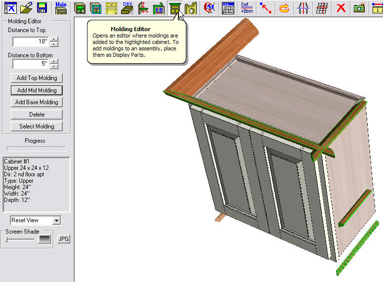

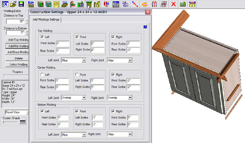

Hi Sergio
I like to put them on in the cabinet editor
Molding Settings.jpg (85.59 KiB) Viewed 3971 times
Molding Settings 2.jpg (89.83 KiB) Viewed 3971 times

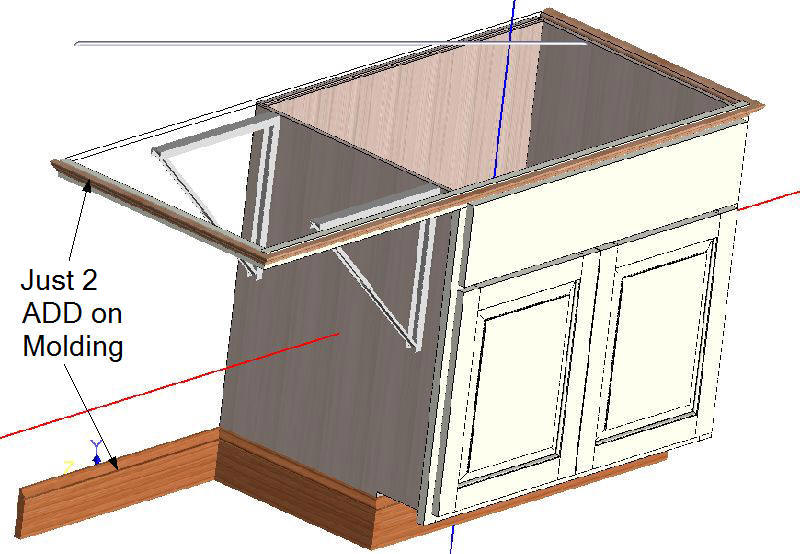

Re: Cabinet Moldings
Add on moldings
1-24" Baseboard
1-24-3/4" Crown
1-24" x 1-1/2" x 3/4"
Molding Settings 3.jpg (80 KiB) Viewed 3951 times

Thanks George,
Those picture are great. I like the idea of using the modling editor, because if you have to change the size of the cabinet the molding changes size as well. Will that be a problem if you have molding for individual cabinets? In other words would that mess it up all this single moldings for each cabinet instead of a whole piece?
Also how did you get that molding to fo around outside the cabinet?
