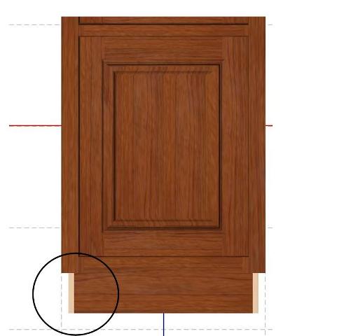

Rick,
Thank you for your reply.
Here is the cabinet. I am not sure if I was clear before, but my toe kick is not separate from the cabinet; they are all one piece.

Re: Toe Kick problem
Sergio, let me know if this works for you.
B18 New TK.hsf
(1.23 MiB) Downloaded 1117 times
Post by Sergio Fetter »
Rick,
This is great. How did you do that? I have tried all kinds of things. I guess I haven't tried what you did.
Sergio, if you hover over the TK you will notice it is a stretcher now. Without knowing what you need in terms of cutlist, method of construction, or display purposes I chose display. You can add a user part name to it for your cutlist. HTH
