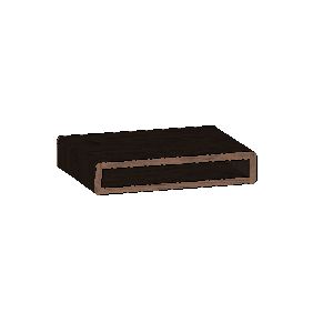

Hi - making this simple dinky cabinet is taking me way too long. I'm just trying to cut a radius on the top and bottom corners of both sides. I don't work with profile cutting very much, but I pretty much figured it out, except it's behaving weird. First, I cut both sides, then changed the back in construction settings to be captured by the top/deck/sides (not dado'd, just butt joint). The left side profile cuts stayed fine, the right side disappeared. Ok, I recut the right side, then it went all weird. I'm attaching two pics here, one (left side) is the way it's supposed to look, the right side is screwed up. Can somebody help here, this is tiresome.

Hey Jason, I tried to resize the height and the right side stayed the same. So what I did is deleted the right side then added a new one and did the cuts. It seems to work now. I noticed your radius is 7/16", and the height of the cab is 3 17/32". Is this correct? I did the PE cuts with 1/2" radius and resaved the cab at 3 1/2".HTH

Hey Rick - thanks for your suggestion. I figured deleting and starting over would work, I just wanted to avoid any more monkeying since I'd redone the P.E. cuts about 6 times already. I'll just assume it was another eCabs random meltdown and get on with my life.
By the way, those dimensions are probably correct - I do everything in metric, so it translates a little weird into standard.
