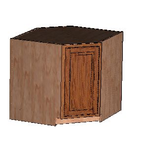

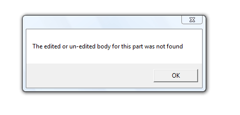

I can not get the top of this corner base into the part editor.Also tried the sides and back.This is the message I get.I did load a base cabinet and it went to the PE just fine.

The cabinet has lost some of its bodies to restore them do this. Select the cabinet then select –remove part editor cuts – from entire cabinet from the mouse tire. I’ll look in to this and see what I can come up with for why this happened. Sorry for the inconvenience

that fixed it.I can now take it to the PE.
