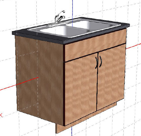

Hi all,
I'm trying to determine the best way to quickly layout a kitchen. Looking at some of the other software I noticed that they include countertop material with the cabinets when placed into a room. They also place a sink and faucet with their sink cabinets. So, here's my idea. I'm figuring on generating a library of cabinets which includes countertop material with each cabinet, plus sinks and such where necessary. I don't want to load actual countertops in the Cabinet Editor because once placed these are not parametric. I was going to use a stretcher as a top, but then I noticed that you can not take a stretcher to the Part Editor for sink cutouts or edge details. (Why not?) The solution I came up with is to use the top as a countertop using an appropriately thick material. Then I place a fixed shelf in the cabinet for the real cabinet box top. When you place cabinets next to each other the top looks like one piece.
For a toe-kick strip I use a stretcher. (I place my cabinets on leg levelers.)
So, what do you all think about this idea? Anybody have any slick tricks they want to divulge?
Ultimately I think it would be great if we could have a selection in the Cabinet/Assembly Editor to apply a countertop that and also have it be parametrically associated with the cabinet box.
Joe

Joe,
I like some of your ideas. Speeding up the time it takes to do a layout is something I think everyone is interested in. I also think that getting a layout done faster in eCabinets may be accomplished by changing the way we use eCabinets.
I like to use the counter top editor to place counter tops but I use some tricks similar to what you are doing. For sink and drop in ranges, I place a top just on that cabinet. This makes placement of the sink holes easier to calculate. I also have saved cutout geometries for most sinks, etc. and can open those in the part editor contour to quickly do the cutouts. After I place these counter tops on sink cabs etc, I go back and finish the rest of the tops that don't have holes. I save my sink bases with the sink and faucet already in place so that I can just add the cabinet and the sink is there. If I have to re-size the cabinet it just takes a second to move the sink into place.

here is what you will have to do to get a price on those display boards. Select both of them and go to file export selection. Then save this file, go to the display part editor and open that file up. Once you have it open click the save button and save the file again with a price this time. Also make sure you check mark cut list part. Go back to your room layout and delete those two display boards in the room. Add the new ones you just saved. Now when you go to the cost sheet it will have the display boards listed, with the price you set in the display part editor when you saved them. It will be under user created. This is one set price for both display parts, or you could do this for each one as well, so make sure you know how much you want to charge to creat them both if you do them as one. Now it should have what you are wanting. If you have any questions please give me a call.

The method I discussed actually uses the "top" of the cabinet as the countertop material. It is not only parametric, but it allows you to change the material in the Custom Layout Editor and will give you rough information about the amount of countertop material needed and the cost. The countertop material in this case is entered as sheet stock. If you like you can enter the sheet size of your actual countertop material. The problem of course is that on a nest the countertop material would be chopped up, so it is definitely not a perfect solution. I don't do countertops myself, so this method should work fine for me. I'm in the process of working the kinks out. My idea with the sink cabinets is to have it such that I don't have to do any extra hole cutting after I develop the library. The hole is also setup with constraints in the CM so the cabinets can be resized width-wise without too much trouble. I just want to plop it in an grab the next cabinet. I have also setup a dishwasher cabinet (GE Profile) which is just a top with a dishwasher display object attached to it.
I will post the job I'm working on when I work out the details and let you know how it works for me.

Another way is to create the display boards in the cabinet ediotr and save them. Go to the room and install these "display boards", which now will be assemblies. When they are placed in the room click on the cost sheet. it will figure these in with the board stock.

You can also make parametric solid wood parts out of cabinet boxes if you like by removing everything in a cabinet except a faceframe member. This will give you cost information, plus you can change the material and resize it even with profiles on it.
