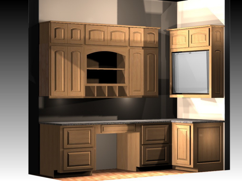

I have to change my sheet stock only. All the cabinets except 1. The face frames stay the same along with the doors and raise panel ends.
The only thing changing is the sheet stock from Maple plywood to wood grain Melamine. Does anybody know a quick fix?

Gary, in your room layout, right click and select Change Materials> Sheet Stock. From there you can select the whole room or just one part.

Rick,
Thanks that works just great :beer:
