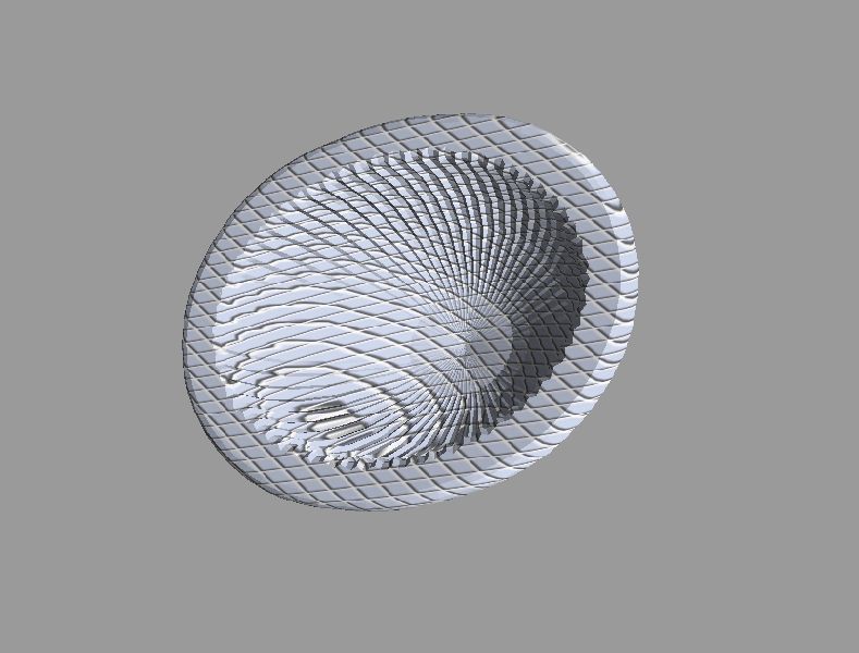

I did get it converted to a stl, but when I gave it texture it came out with hatch marks. Here is the sink

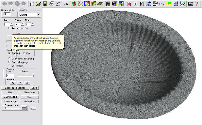

Re: How to get Kohler sink image
Gary,
I tried it also and using the gourad setting it looks fine . The only problem I see is the cross hair look in the center of the sink but that is a problem in the original model and it doesn't bother me enough that I wouldn't use it in a presentation.

I went to the Kohler site and copied the color skyblue for the sink and this is what I get.
Gary
Gary,
It is tiling the image instead of stretching it. Just use the color controls in the Display Part Editor to get your color instead of using the image. You can also find many colors in the Formica and Wilsonart folders using the Display Part Editor.
Joe Dusel
Posts: 1117
Joined: Tue, May 17 2005, 9:40PM
Location: Vista, CA, U.S.A.
Post by Joe Dusel »
Did you crop the image before using it? If you did not I''m assuming the pattern you are seeing is the border of the image you used. I would just try setting up the colors to get close to what you need.
