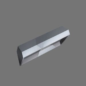

I am looking for a Broan Elite 64000 series stainless range hood or something that will look somewhat similar. The important thing is that I can make it 48" wide, 10" tall and close to 21" deep. As always, any help is greatly appreciated!
Re: Looking for a Broan Elite 64000 series range hood or similar
Derek,
Will this work?

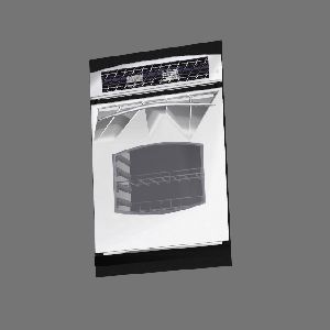

Kerry, I don't suppose you or someone else could help me out with one more thing. Maybe I should have posted this on it's own, but I've been trying to convert the cad file for my oven into a hsf but even though I get it into ecabs, it looks awful. I used the programs recommended in this forum, but I think my problem is not knowing enough about how to apply the textures to the 3d files. My original post is here : http://www.thermwood.com/forums/viewtop ... f=5&t=8352. Any help with it would be incredibly appreciated! thx again!

I got it to look all one color of metal but could not get the top controls to be black and could not get the glass to be transparent sorry. Hopefully Kerry will get this post and tell us both how to do multible textures.

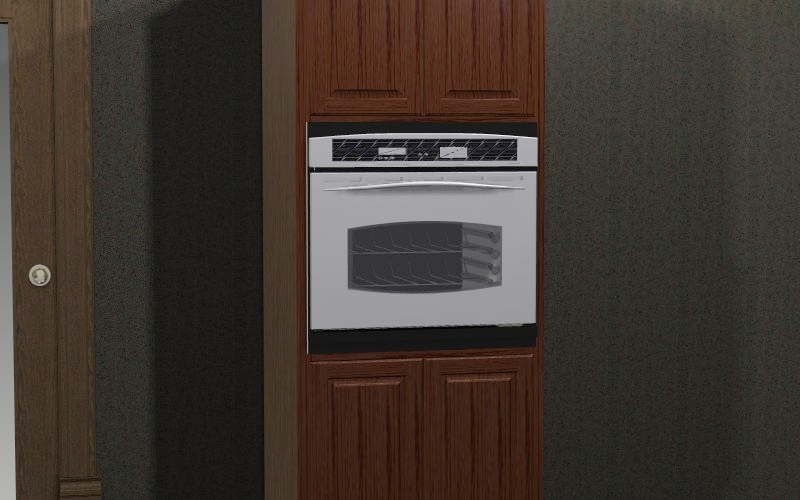

Here is the oven.
You of course can open it in the Display Part Editor and right click on the seperate parts to change textures etc.

Gary,
You must take the .dwg drawing you download from the GE site and open it in Intellicad then use the explode command. Sometimes you have to use explode twice to break the drawing into it's separate parts. You then have to rotate the drawing and select different parts of the drawing and save them each to a separate layer as a new drawing. Save this as .dxf. After you separate these parts you can open each of them in Accutrans 3D and save each layer as a different part converting them to .stl format. You can them open the .stl files in eCabinets Display Parts Editor and apply textures.
You can download my oven drawing and you will be able to right click on the parts and adjust textures. I broke the oven into eight different parts.

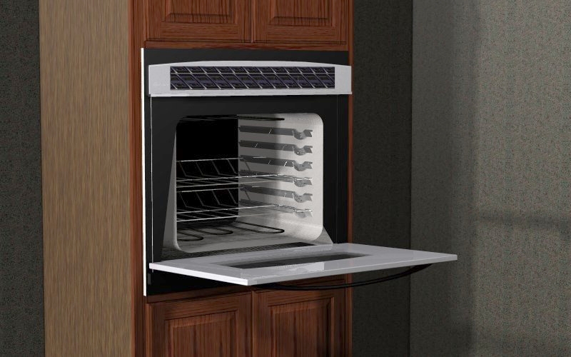

Gary,
By separating the parts you can create models that do things like show the oven door open.
