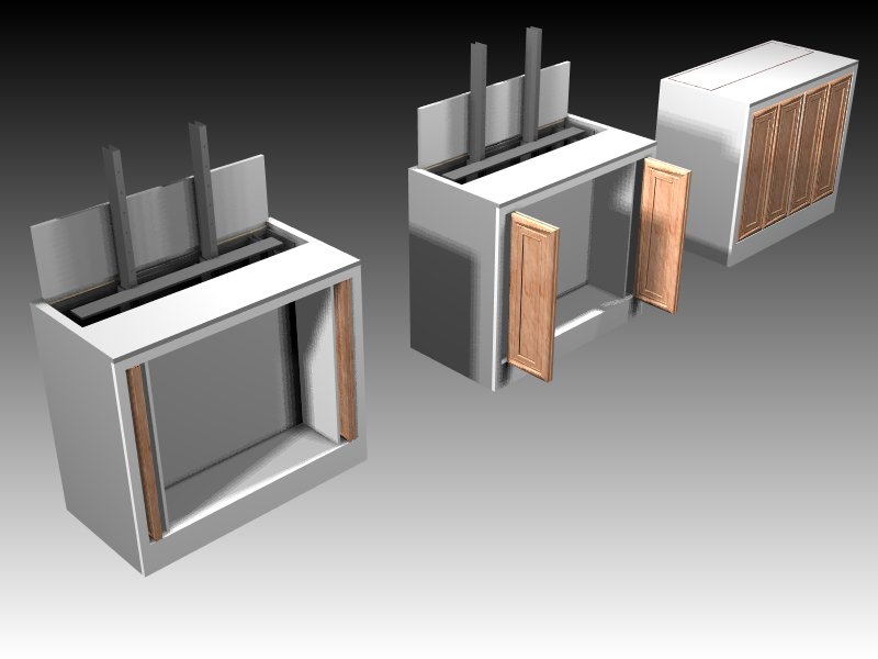

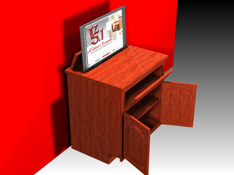

Hi Joe are you looking for something like this
Tv Left_1.jpg (62.73 KiB) Viewed 7546 times
TV Cab_2.jpg (52.52 KiB) Viewed 7546 times

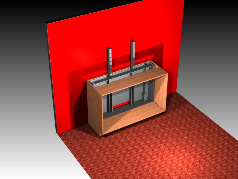

Yes,George, that's pretty much what I'm trying to do. I finally used a modified FF for the top - only way I could figure to place a "door" in it. And my cabinet isn't deep enough for equip in front (your drop-down drawer front), so I put in a separator panel (using Kerry's up-down stretcher idea) using the front compartment for DVD/Video storage
I'm using bifold pocket doors so I need the side compartments for the pockets. The lifter I'm using is the Whisper-Ride, but I don't have an image file for it.
Do you mind If I ask where you got the lifter image ? And how did you do the cabinet ?
Here's my cabinet assy file for a look-see
Pop-Up TV Cab w_FFtop.esa
(578.02 KiB) Downloaded 572 times

Hi Joe I made the left about 2 years ago.
It's all in the Zip File.
