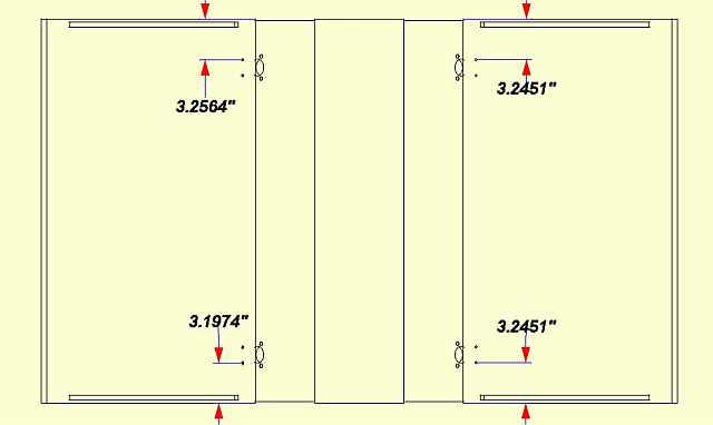

Dimensions for hinges are different from one gable to another. The cabinet uses the same settings so how come?? Anyone have some ideas on this one?? TIA

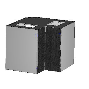

Here's the file.

If you nest the cabinet, it looks like the right end has the hole pattern twice.

Rick Palechuk wrote:If you nest the cabinet, it looks like the right end has the hole pattern twice.
Thanks Rick -- You reminded me that there was originally hinge holes on the right gable done in the PE. I removed these and everything is good to go.
