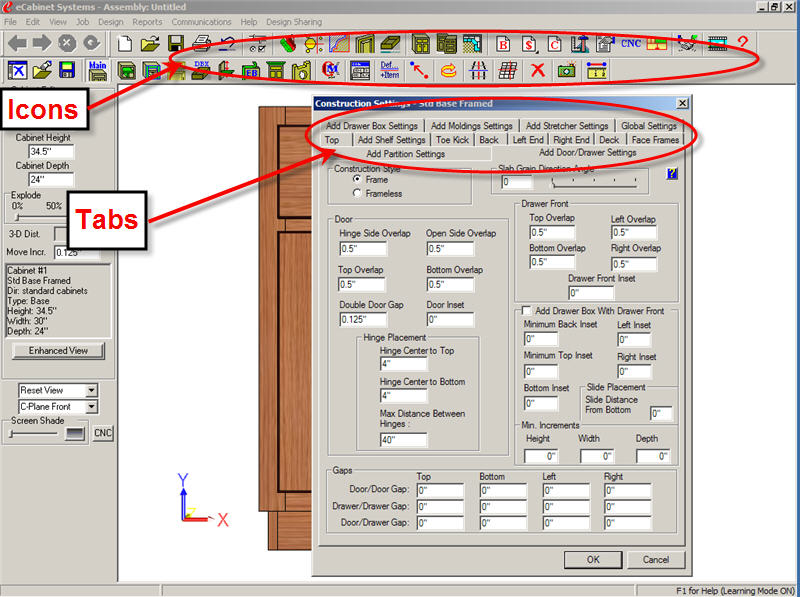

You were confusing me by using "tabs" to describe icons (see attached image). I could not think of anywhere with a camera "tab."
Do not confuse rendering a presentation view with creating a JPG image--they are two distinct and different functions. Rendering merely displays the image on screen while creating a JPG creates a formatted file in memory while displaying the image on screen. Creating a JPG is one area where eCabinets is not Vista-compliant.
Icons and tabs.jpg (108.14 KiB) Viewed 30708 times
